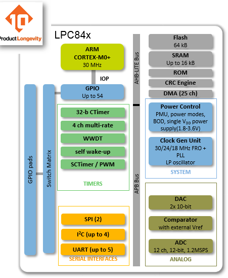

Introduction
Based on the ARM Cortex-M0+ core, LPC84x is a low-cost, 32-bit MCU family operating at frequencies of up to 30 MHz. The LPC84x MCU family supports up to 64 KB of flash memory and 16 KB of SRAM.

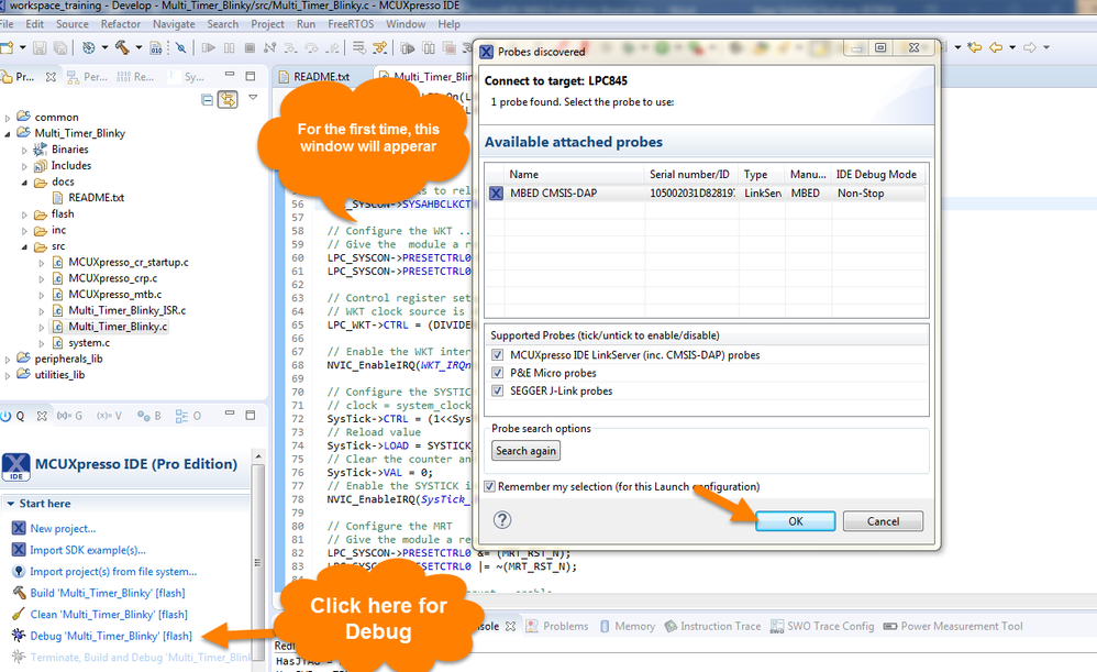

Build, run and debug an example
This section describes the steps required to build, run, and debug an example application.
1. Download the LPC845 Example Code Bundle MCUXpresso from the next link:
http://www.nxp.com/products/microcontrollers-and-processors/arm-processors/lpc-cortex-m-mcus/lpc800-...

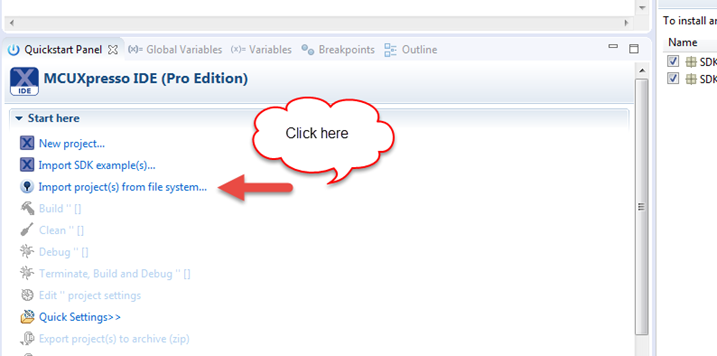

2. Open MCUXpresso IDE.
3. Select "Import project(s) …" from the Quickstart Panel.

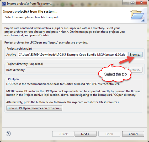

4. Click the "Browse" button and point to the LPC845-Example-Code-Bundle-MCUXpresso.zip, which should be downloaded previously, and then click “Next” button.

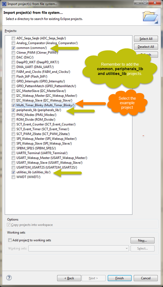

5. By default all the projects are selected, however you can select only the desired example project. In order to build the example project, it is necessary to add in the workspace the following projects:
  • common
  • peripherals_lib
  • utilities_lib
For this document, we are using the Multi_Timer_Blinky example project.

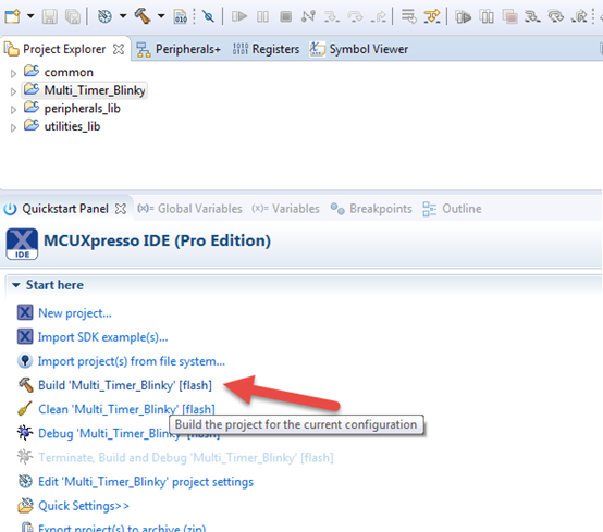

6. Build the project using the hammer icon on Quickstar Panel.
 7. Connect the development platform to your PC via USB cable. If connecting for the first time, allow some seconds for the devices to enumerate.

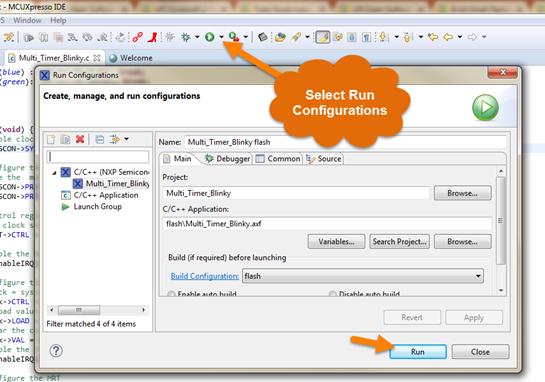

8. This example runs from Flash. To run this code you have two options:
a) Download and Debug.
   b) Load to flash using the “run” IDE icon and press the reset button on the board.
Note: It may be necessary to power-cycle the board in order to regain control of the reset button after programming.
At this moment, you can be able to run or debug the example project.
