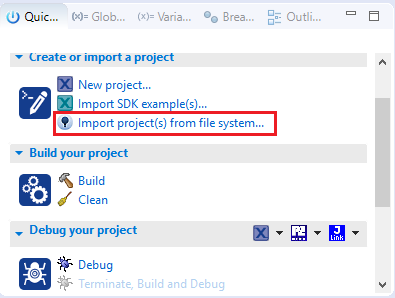

Once downloaded, we import the library project into the workspace using the ''Import project(s) from file system... from the Quickstart panel in MCUXpresso IDE:
Figure 1. Import Projects.

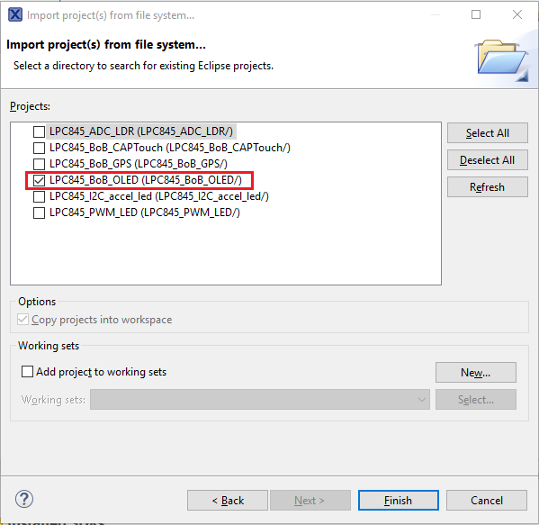

Press next, and see that are a selection of projects to import, in this case, only keep select the LPC845_BoB_OLED how it looks in the picture below:Fig 3. Select OLED project.png
Figure 3. Select the OLED Project.

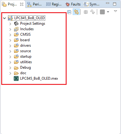

Press finish and the project example shows up in the workspace:
Figure 4. OLED Project in workspace.

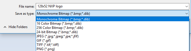

First, you have to create the image using any kind of graphics software such a paint, Photoshop, etc and save the picture as Monochrome Bitmap (bmp), make sure that the image size match whit the OLED size.
Figure 5. Save picture as Bitmap.

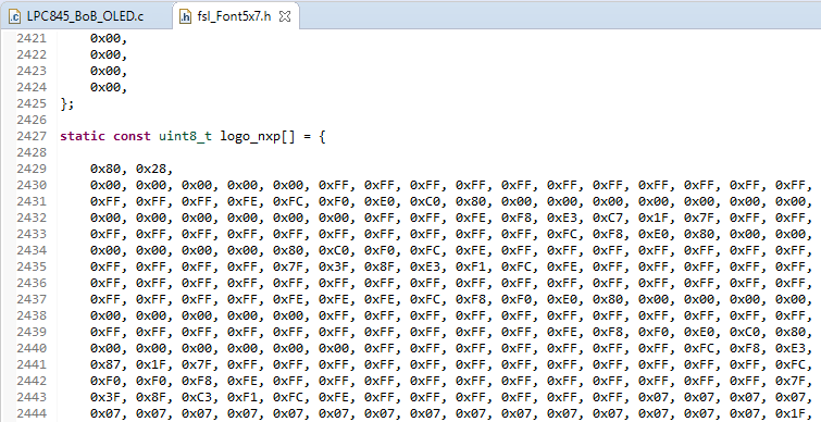

To import the array go to file >> save the output, choose the place where are going to save. Then inside the example, go to fsl_Font5x7.h and paste the array.
Figure 7. Data Array.
   *Note: Inside the example, the array for the NXP logo is already there, if you want another image, delete this array and pas the new.

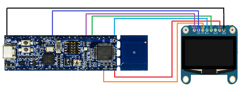

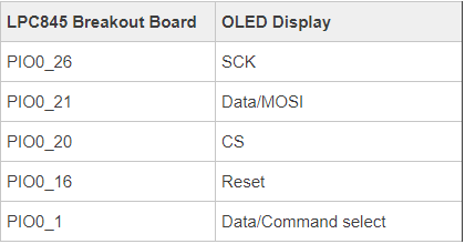

Now, with the project already in the workspace, it is time to set up the connection between the LPC845 Breakout board and the OLED Display. The table below shows which LPC845 Breakout pin are routed each line of the SPI interface and the pins for reset and Data/Command select.
Table 1. Connections.
You can check the Datasheet of the board, of bases on the picture below to see where the pin are, note that GND and 3.3V also needed for the OLED display:
Figure 8. LPC845 Breakout to OLED Connection.
