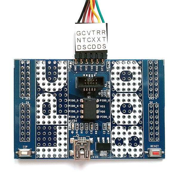

  1. The first step you will need to do is connect you UART to USB adapter cable to the 'FTDI' header on the top of the LPC800 Mini Board. The pin layout is setup to match FTDI's popular cables by default, specifically the 'TTL-232R-3V3'. Other adapters can of course be used, but you will need to connect the GND, VCC, TXD and RXD pins in the right location yourself. FTDI's TTL-232R-3V3 cable is shown connected here as a reference:
    LPC800-mini-board
  2. The next step is placing the LPC810 in 'ISP' mode. This is accomplished by pulling PIO0_1 'low' during reset, which causes the bootloader to enter ISP mode. The LPC800 mini board conveniently has an 'ISP' switch – the white button in the bottom left-hand side of the board – which we can hold down to pull the ISP pin low. While continuing to press the ISP button, press and then release the 'RESET' button (the red button on the opposite side of the board). This will cause the board to reset, the internal bootloader will see that the ISP pin is low, and it will enter ISP mode where we can program the flash in Flash Magic using the on-chip UART0 peripheral.

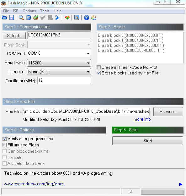

The next step requires you to download and install the latest version of Flash Magic if you haven't already done so. It's available for free at http://www.flashmagictool.com/. Once installed, open the tool, and the run through the following steps:
  1. Setup the 'Communications' options:
    1. Select LPC810M021FN8 as your target device
    2. Set your COM port to whatever port your USB to UART adapter enumerated as (you can find this in the device manager in Windows)
    3. Set the Baud Rate to 115200, or whatever matches your USB to UART adapter
    4. Make sure that the 'Interface' is set to 'None (ISP)'
    5. Set the Oscillator to '12', which matches the speed of the IRC used by the bootloader

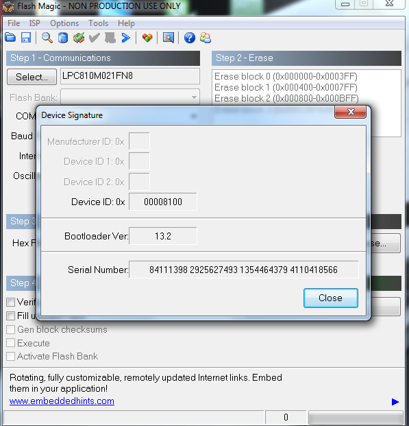

  2. You can double-check all of your communications settings and connection by selecting the 'ISP > Read Device Signature …' menu item. If you are in ISP mode and properly connected, with the right 'Communications' settings, you should see something similar to the following screen:FlashMagic Device IDIf you get an error message, double check your connections and your settings in Flash Magic, making sure you are actually in ISP mode on the LPC810, and that you've selected the right COM port.
  3. Check the 'Erase blocks used by Hex File' checkbox in the 'Erase' section.
  4. Select your hex file in the 'Hex File' section: Use the 'Browse' button to point to the Intel Hex file generated by your toolchain or IDE (for example, LPCXpresso). You can also use one of the sample .hex files available here if you don't have a .hex file ready yet.
  5. You should end up with Flash Magic configuration as follows ('Verify after programming' is optional):
    Flash magic settings:
  6. Now click the 'Start' button to program the flash …
  7. … and finally, once the device has been programmed, reset your board (via the red 'Reset' button).
