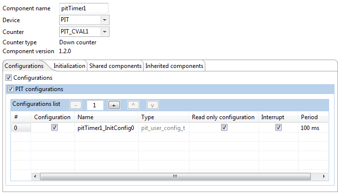

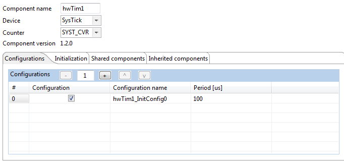

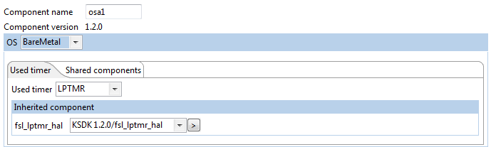

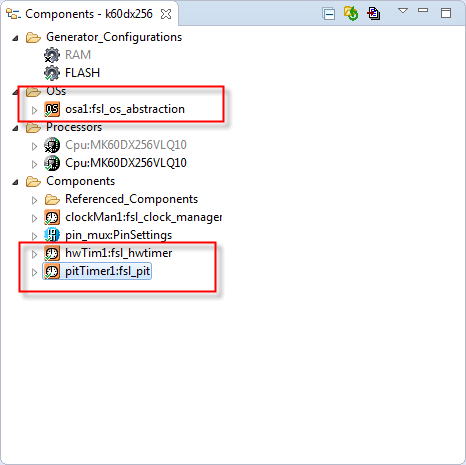

Yes, Alice is right, it is not allowed to use PIT peripheral simultaneously with fsl_hwtimer and fsl_pit component, but you may configure sys_tick for hwtimer , and PIT for fsl_pit component, then no conflict at all. Please also note you have to change OSA's Timer to LPTMR to leave sys_tick for hwtimer. Please kindly refer to the following for details.
Hope that helps,
Kan

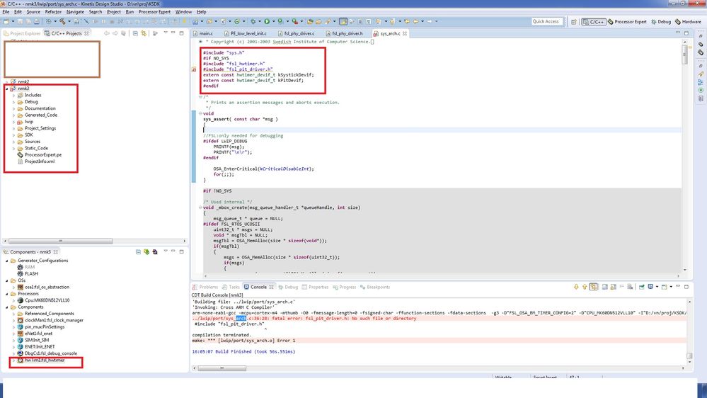

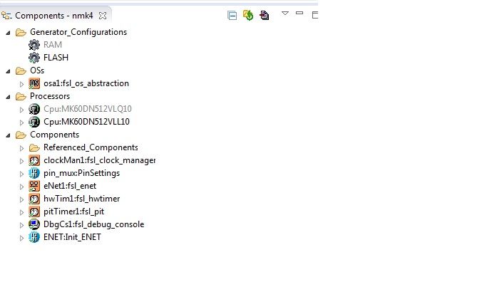

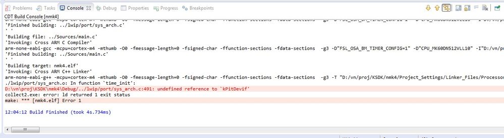

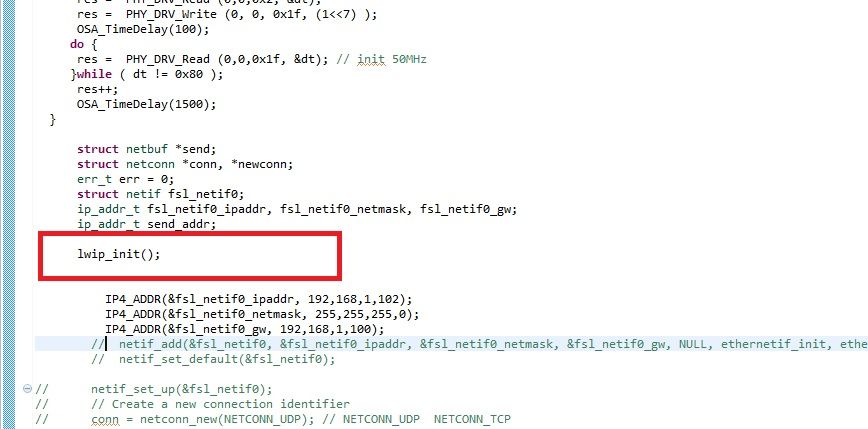

profprogrammer
Hi Kan.
I read your message and do it
but when I decided to carry out initialization of a stack the compiler gave out a mistake.
1,346 次查看
