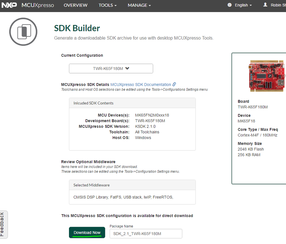

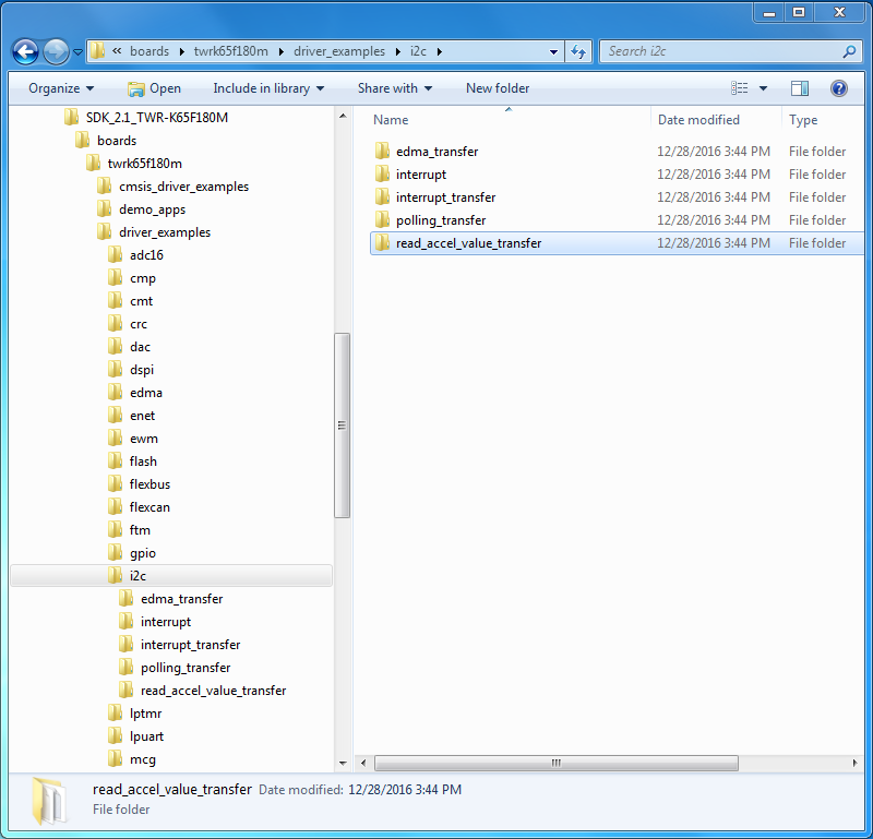

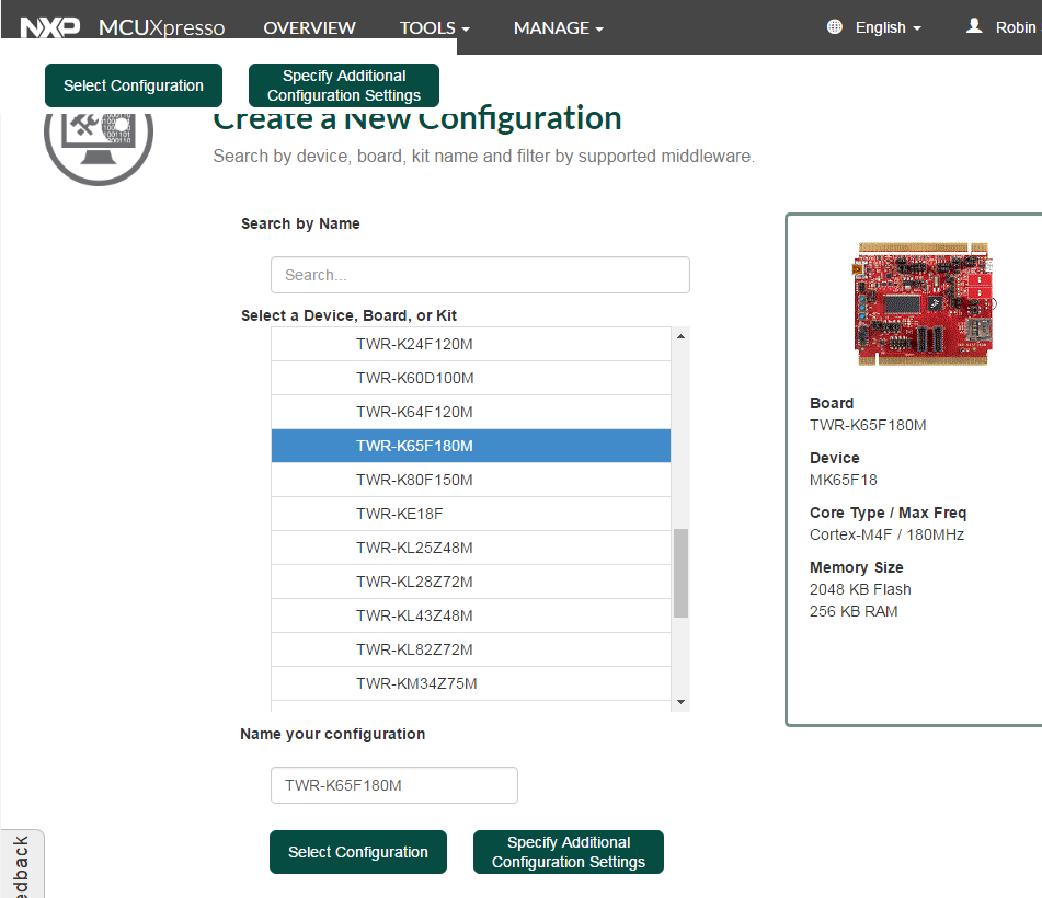

Please refer the "read_accel_value_transfer" example in SDK_2.1_TWR-K65F180M.
Select TWR-K65F180M then download SDK_2.1_TWR-K65F180M.
You can getting start with KSDK reading "How to start with KSDK".
Robin
