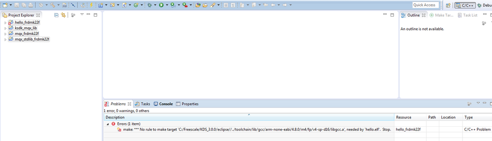

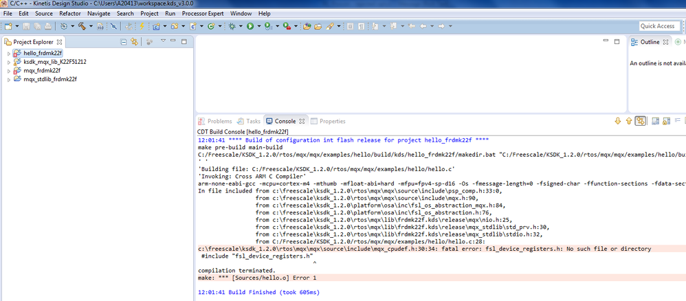

I'm trying to import an example project into KDS and trying to build and debug on a FRDM-K22F brd.
During build it stops in the middle of execution with the following error message. What am I doing wrong?
Any help will be appreciated.
Thanks.

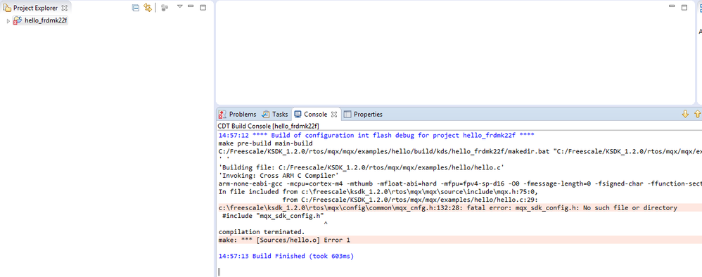

Deejay
Hi Jorge,
Thank you for responding me and pointing me in the right direction. Yes I missed those essential bits to include in the build.
I've imported those library projects and tried but I still get the error message. See here. Any suggestions?
Thanks again.
DJ

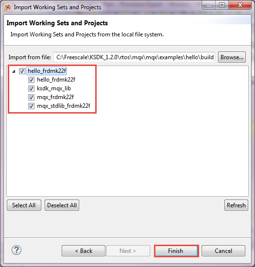

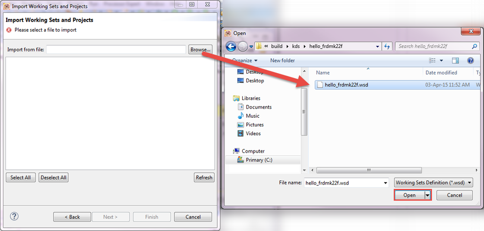

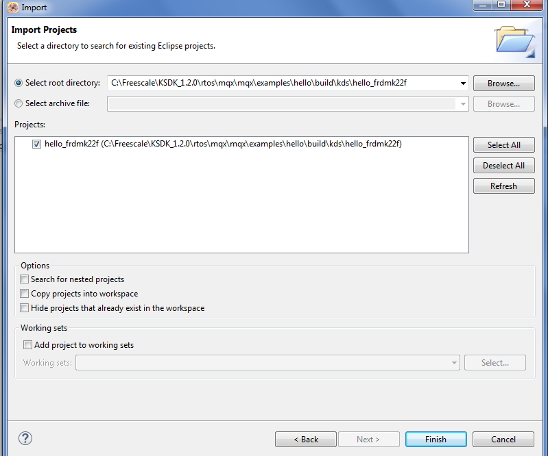

Just in KDS 3.0 go to File -> Import
Find the demo, which you want to use (in your case hello demo for frdmk22f)
C:\Freescale\KSDK_1.2.0\rtos\mqx\mqx\examples\hello\build\kds\hello_frdmk22f
And import all needed libraries
after that you will see
Please, tell me, if it is ok and if it is help you.

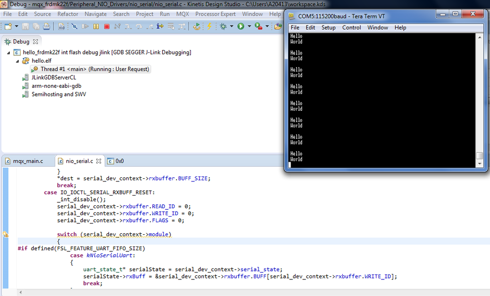

KDS v3.0.0 / KSDK v1.2.0

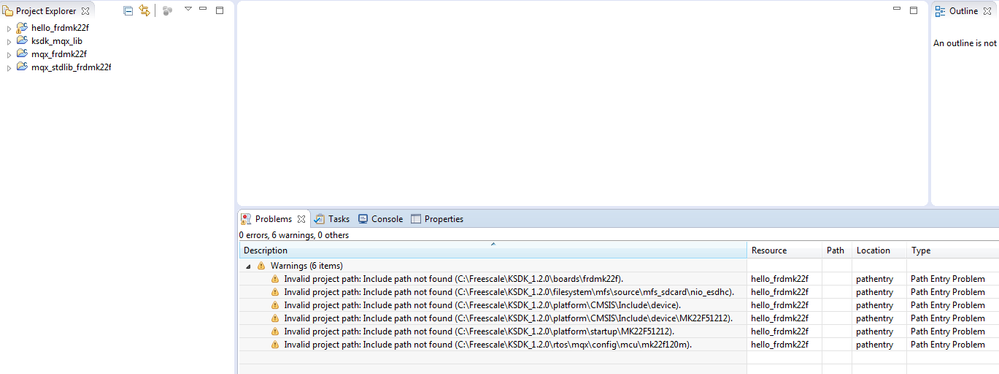

I don't even have to build the project as soon as I imported the project files I see these 6 warnings, and if i try to ignore the warnings and compile them then it will lead me to the errors that I explained earlier.
KDS v3.0.0 / KSDK v1.1.0
Again, this combination is also producing errors as per the below screen capture!
KDS v2.0.0 / KSDK v1.1.0
Finally, the combination of earlier versions (KDS v2.0.0 and KSDK v1.1.0) seem to work.
It would be helpful if I can get this running with the current versions (KDS v3.0.0/KSDk v1.2.0).

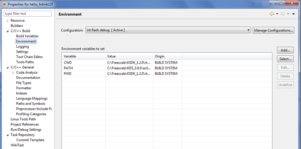

Hi Devan Jeyadevan,

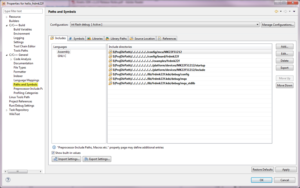

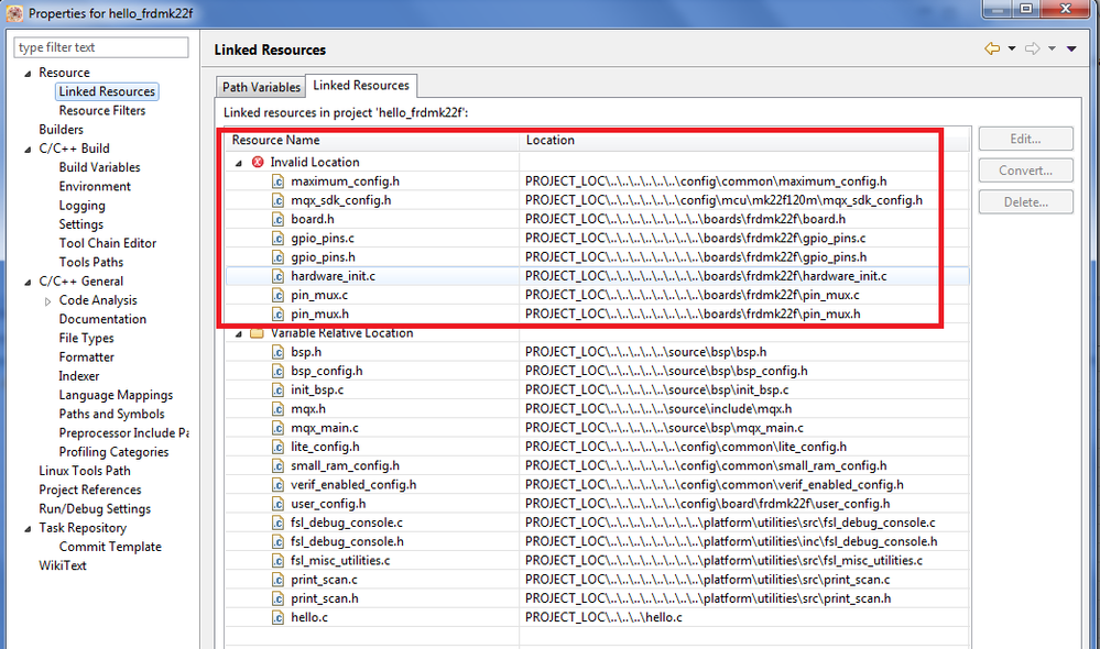

it could be problem with paths.
Please, can you check your paths ?
By right click on your project > Properties
and check paths for your project.
Thank you,
please, tell me the result.
Iva

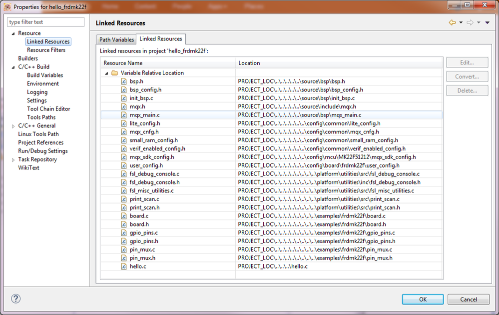

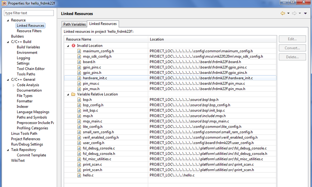

Deejay
Hi Iva,
See below. Thanks.
5,370 Views
Deejay
Hi Iva,
Is this invalid location for those files causing the problem? Thanks.
5,370 Views
DavidS
Hi Devan,
The Linked Resources path errors have paths pointing to KSDK_1.1.0 path layout.  Weird!
The board files should lead to a path C:\Freescale\KSDK_1.2.0\examples\frdmk22f for KSDK_1.2.0.
Are you using version control or other software that might have messed with files/projects?
Hate to say but you might want to uninstall and re-install from scratch.
David

ivadorazinova
Hello Devan,

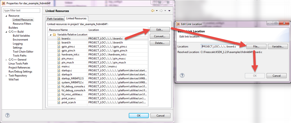

It looks you import example from KSDK 1.1 - because if I see your screenshot again (with Invalid Location), in KSDK 1.2 there is no folder boards.
This folder is for KSDK 1.1. (please see below). It looks as some remains from KSDK 1.1
and there is difference. There is no boards for 1.2.
So, please, can you try to modify your path for your invalid location?

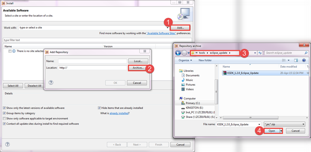

Just notice, please, have you installed eclipse update for KSDK to KDS?
I mean:
Please, tell me if it helps.

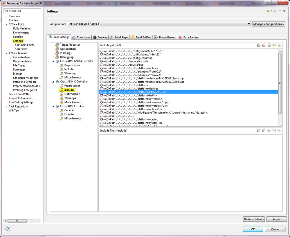

Deejay
Hi Iva and David,

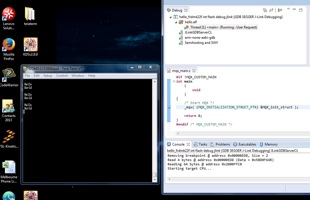

Sorry to say but I'm not so lucky with all of your worthwhile suggestions except taking the hard road as David suggested earlier. I uninstalled both the versions of KSD (v2.0 & v3.0) and KSDKs (v1.1.0 & v1.2.0) and installed back KDS v3.0 and KSDK v1.2.0, installed all the sw updates, etc. This fixed the issue now and all seem to work now. :smileyhappy:

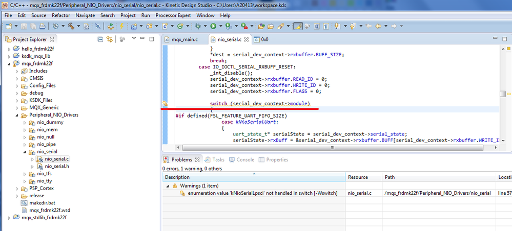

Now I can build, link, debug and run the program. However, there is a warning that might be further looked into if you could. See the 2nd screen shot further below for details.
Once again, thanks heaps to both of you for taking time to resolve this issue for me and I must say that I learnt a few things along the way as I was trying all those good suggestions.
Have a great day folks!:smileyhappy:
Cheers!
Devan

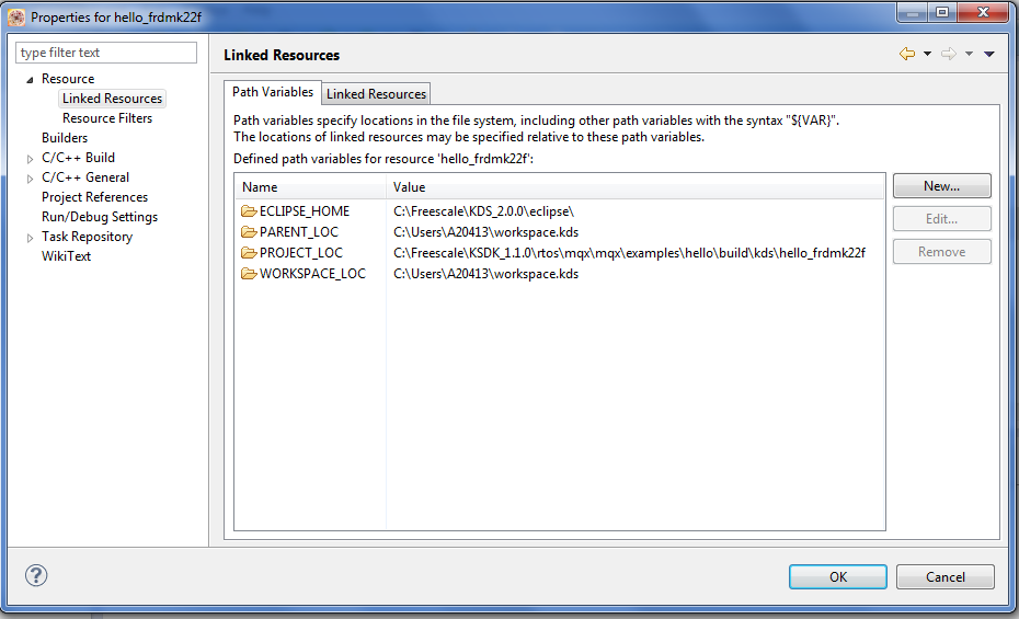

ivadorazinova
Hi Devan,
please and do you use new workspace for your new KDS?
I mean separate workspace for KDS 2.0 and new workspace for KDS 3.0.

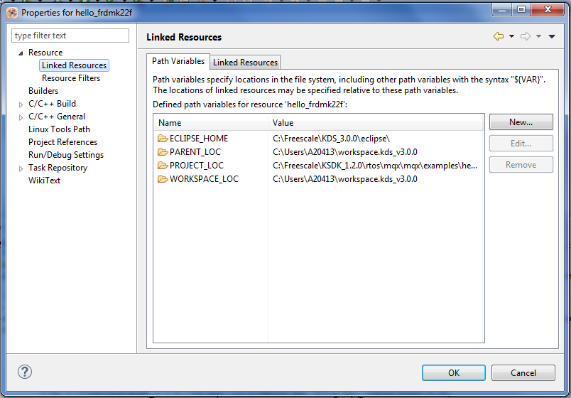

Please, check PARENT_LOCK and WORKSPACE_LOC in Properties->Resource->Linked Resources for your project in KDS 3.0 and for older KDS 2.0.
Iva
5,370 Views
Deejay
Hello Iva,
Yes I do use separate work spaces for both versions. Pls see below.
This is for KDS v3.0.0.
This is for KDS v2.0.0.
