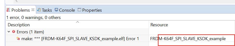

I tried to build this project, but unfortunately gave me make*** file error error_kds.jpg
that I could not solve, I'm not sure what is the problem,
can anyone help me with that?
