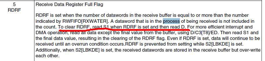

Hello niki,
I think this is just read the D register , the aim  is clear the RDRF Flag.
You can see this in the RM
you can confirm it through the your project .
Hope it helps
Alice Yang
