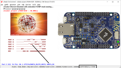

I have also attached a K64 application that sets up the same ports for UART4 and will echo receptions or allow a command line interface to be used. The K64 runs from 48MHz HIRC so will work on any HW. You can verify HW and check the register setups in the debugger as comparison.

If you haven't already invested a lot of work specific to the environment you can also look at the uTasker project (it is available as open source, free commercial or supported commercial) which gives a similar UART interface - see below, and has been used sucessfully in many K64 industrial application with lots of intensive UART interface s(4G modems, Modbus, RF interface etc.)

It allows the K64 to be simulated in real-time so you can connect UART devices to the PC and develop, test, debug without needing the HW, which dramatically improves development efficiency (its simulator makes setup errors immediately visible and will warn of anthing that it finds being used out of specification, etc. If you need a different Kinetis or an i.MX RT upgrade applications developed with it will also run there with virtually no porting effort (apart from defining the new pin mapping).

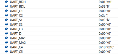

These are the registers after configuring UART4 for interrupt operation. Please compare with the values you have by viewing them in the debugger.

stdcerr
Thank you for this! I'm working on testing the UART functionality in isolation of any other parts of the project to be able to get to the bottom of what's happening exactly! I do appreciate your help and availability for further communications, which I might come back to!

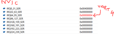

However use the debugger to see whether the UART's status register is showing the rx interrupt flag set or not when you send a charcater. Check the interrupt enable mask in the UART and then check the NVIC to see whether it is not being left masked for UART4.
You should also see received bytes in the UART Rx Data register - if not check the UART clock. The K64 has 6 standard UARTs - UARTs 0 and 1 are clocked from the system clock an UARTs 2..4 from the bus clock.
