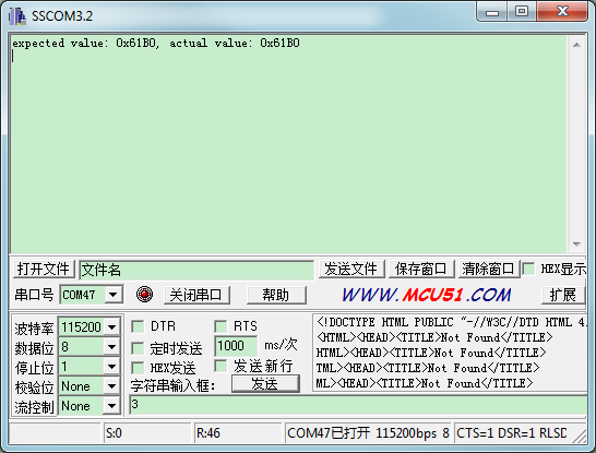

Please refer below code, which I had done the test with TWR-K64F120M board:
void crc_test(void)
  uint32_t data_out;
  int i;
  SIM_SCGC6 |= SIM_SCGC6_CRC_MASK;
  // test CRC-16 feature with seed 0x0, data 0x4142, poly 0x8005, expect CRC result 0x61B0
  CRC_CTRL = CRC_CTRL_TOT(1) | CRC_CTRL_TOTR(2);
  CRC_GPOLY = 0x8005;
  CRC_CTRL |= CRC_CTRL_WAS_MASK;
  CRC_DATA = 0x0;
  CRC_CTRL &= ~CRC_CTRL_WAS_MASK;
  CRC_DATA = 0x4142;
    // wait for finish CRC calculation
    for(i=0;i<20;i++)
   // read result
   data_out = CRC_DATA;
    if(CRC_CTRL&0x20000000)
        // byte transposition
        data_out = data_out>>16;
    else
        data_out &= 0x0000FFFF;
    printf("expected value: 0x61B0, actual value: %x\n", data_out);

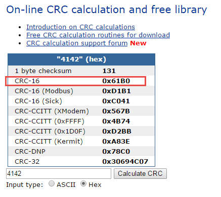

You could verify the CRC-16 result from below link, and I also attached the CRC-16 calculation result for your reference.
http://www.lammertbies.nl/comm/info/crc-calculation.html
