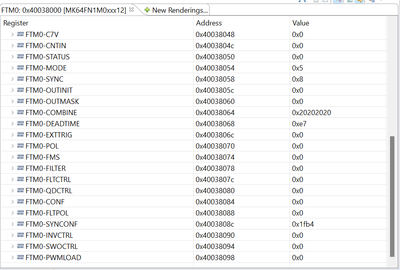

I can see that the registers are updated with values but still cant see output on either PTA1/2 or PTD 6/7

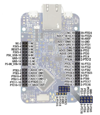

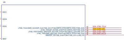

Due to the fact that PTA 1 and 2 are connected to the JTAG (it can be seen in the attached images) there may be an interference from the K20 when debugging. Therefore to prevent this you can try powering the board from the USB port. If this does not work, provide me your code to check if there is any problem.
