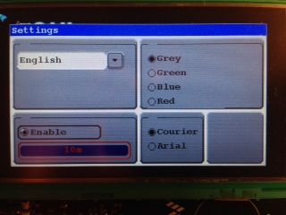

I can run the eGUI 3.0 demo on the TWR-LCD-RGB just fine, but a couple of graphic objects don't show:
1) None of the Group Box Titles show but the group boxes and their content show fine.  I see the title text strings in the code but for some reason they don't get displayed.
2) The OK button in the Settings screen does not show it's title text "OK", the button just shows a blank button.  Again I can see the title text strings in the code but for some reason they don't get displayed.
Please explain why these text strings are not showing.  All other text strings for the various objects display fine.

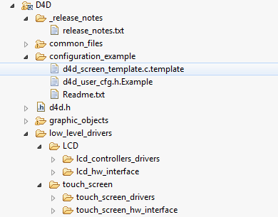

Hi Elisa,
1) As far as I know the D4D libraries are intended to be used on an RTOS in this case MQX
2)
this is the structure of the D4D files in the project .
3) you can have a file with all the Bitmaps,  for more information about how to show them check here.
there are the macros that are used to declare the pictures and show them and how you are supposed to  use them.
Regards.

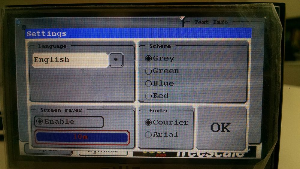

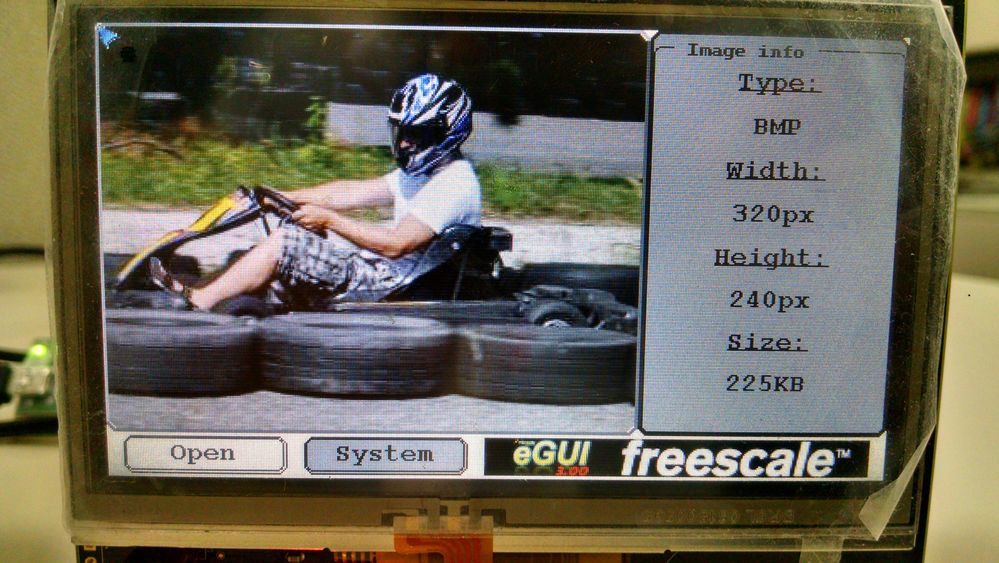

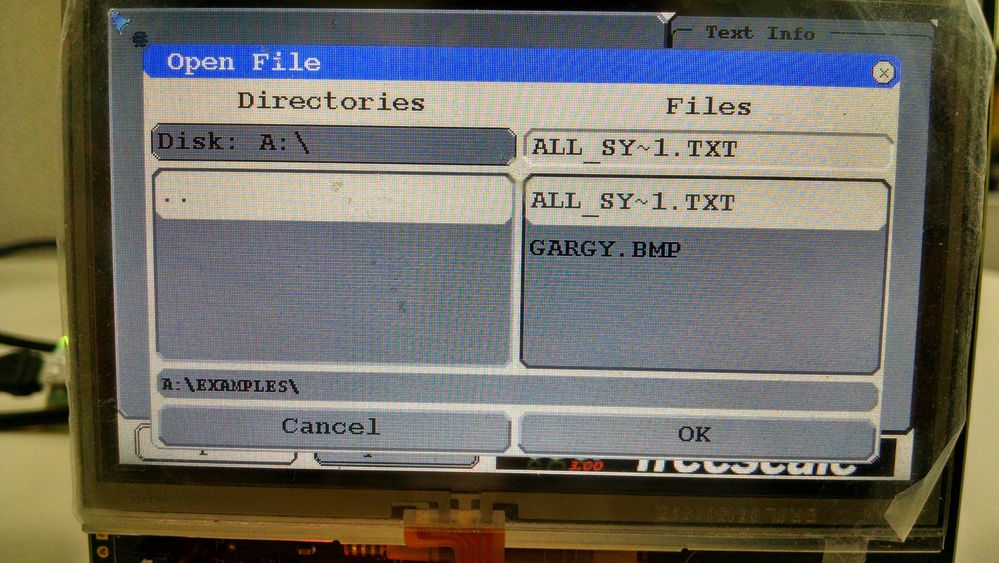

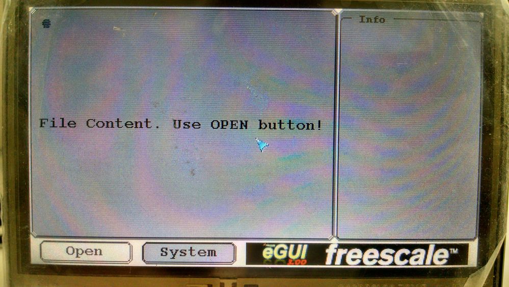

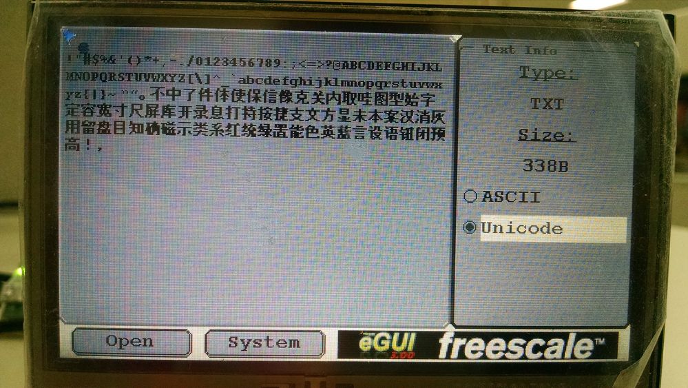

I downloaded the eGUI from  Gargy007/eGUI · GitHub​, I ran it in IAR 7.40.2.8570 with MQX 4.2 and the demo shows the group box titles and the text's buttons OK.
I took these demo's photos. If you have problems please attach some photos to see the demo's behavior.

I just now downloaded eGUI 3.0 again from   Gargy007/eGUI · GitHub,  compiled it in IAR EWARM 7.4, and ran it on the TWR-K70 with the TWR-LCD-RGB and attached is a photo of the Settings screen.  As you can see, everything displays and works fine except none of the Groupbox titles show, and the OK does not show but the button still works.  Also, after loading the ALL_SYS....TXT file it shows blank in the left window pane regardless of ASCII or Unicode selection.  The TXT file appears to be loaded fine because it says it's size is 338B.

Please be sure that the SD card is inserted when the demo starts and be sure that the files "Arial8.d4l" and "CourierNew8.d4l" are located in the path "SDCARD:/Fonts/" (the files that you need in the SD card are located in "eGUI-master\_Official_Demos\EGUI_Demo\SD_Card_Content\Fonts" in the repository that you downloaded from Gargy007/eGUI · GitHub​).
Earl.
6,950 Views
GeneGoff
That was it!  Thanks Earl!  Now I see the FONT_SYSTEM_SMALL was referencing a file using D4D_DECLARE_FONT_FILE rather than a font descriptor.  I don't know how the project knows to get the file from the SDCARD:/Fonts folder.
