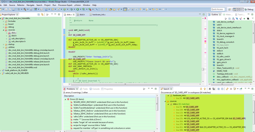

i want to show my SD as a MSD using SPI protocol.
here i attach my implementation.
first i enable SD_CARD_APP function (Macro).
then i set block_no and block_size
case USB_MSC_DEVICE_GET_INFO:
device_lba_info_ptr = (device_lba_info_struct_t*) size;
#if RAM_DISK_APP
device_lba_info_ptr->total_lba_device_supports = TOTAL_LOGICAL_ADDRESS_BLOCKS_NORMAL;
device_lba_info_ptr->length_of_each_lab_of_device = LENGTH_OF_EACH_LAB;
#elif SD_CARD_APP
#if (OS_ADAPTER_ACTIVE_OS == OS_ADAPTER_SDK)
device_lba_info_ptr->total_lba_device_supports = 63;
device_lba_info_ptr->length_of_each_lab_of_device = 512;
now i change read_request and write_request and send_data complete event in usb_class_callback
case USB_MSC_DEVICE_READ_REQUEST:
lba_data_ptr = (lba_app_struct_t*) size;
#elif SD_CARD_APP
 returnCode=MMCReadSingleBlock(lba_data_ptr->offset >> SDCARD_BLOCK_SIZE_POWER,&buffer_s);
 USB_PRINTF("RC:%d",returnCode);
 g_msc_bulk_in_buff=buffer_s;
if(data != NULL)
*data = g_msc_bulk_in_buff;
lba_data_ptr->buff_ptr = g_msc_bulk_in_buff;
is it true?
i just run the project with this edition there are create disk and ask for format. when i apply  to format format is not completed.
my question is that what should i do for stop format disk and show sd data to that disk instead of RAM.

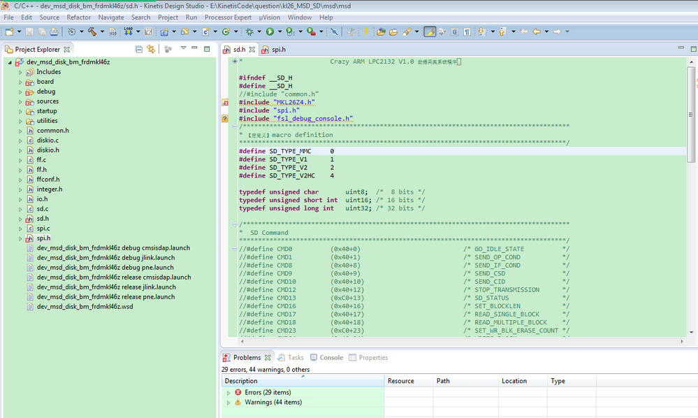

kerryzhou
HI Arth Shah,
   Do you test it on the KL26 KSDK?
  I build your project on my side, it has errors:
Kerry

kerryzhou
Please tell me the msd project path in the SDK_2.3.0_FRDM-KL46Z, maybe you also can send me your modified SDK, you can delete all the other project which is not used.
Kerry
6,828 Views

kerryzhou
Hi Arth Shah,
I check the SDK1.3.0 msd code for KL46:C:\Freescale\KSDK_1.3.0\examples\frdmkl46z\demo_apps\usb\device\msd
, I found the official msd code already add the sd card structure. Please search SD_CARD_APP,
  In dish.h, please modify these code:
#define RAM_DISK_APP                        (0)//1
#define SD_CARD_APP                         (1)
Then the MSD buffer won't use the RAM, it will use the SD card, then you add your MSD code to the according place.
  Please try it by yourself.
Wish it helps you!
Kerry
