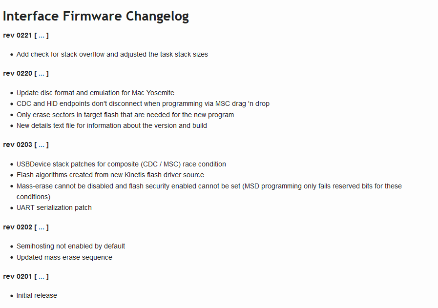

I think the old bootloader on your hand might be rev 0201 or 0202, and the difference between them and latest version can be referred via the following snapshot,
Please refer to Firmware FRDM K64F - Handbook | mbed  for more details.

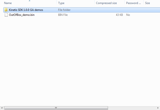

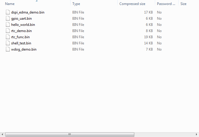

Would you please send your project for a review? BTW, would you also specify the demo that can work well with both boot loaders? is the outboxdemo? or one of the Kinetis SDK 1.0.0 GA demos?  Please kindly help to clarify:-) Thanks for your patience!

If the loading fails, check the error file that records the reason.
In older versions, any flash configuration values that are not 0x00 (apart from the security byte) cause the loader to reject the file - this may be an explanation why your code doesn't work with all loader versions.
