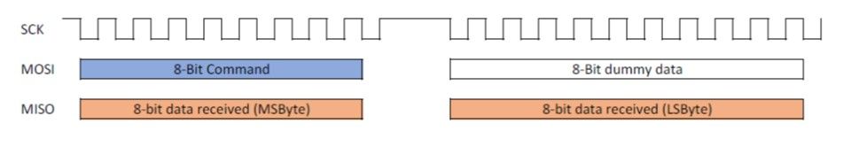

It is necessary to analize how the slave needs data to be received. For example, If device needs 8-bits command data and then return 16 bits-data, transaction needs to be as follows:

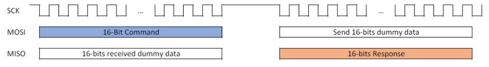

On the other hand, if device needs 16-bit command data and then returns 16-bit data, transaction needs to be as follows:
In this case, if you are using the SPI0_Send_16Bits_Data() function, transaction may be as follows:
As you can see, you must ensure transactions are done as slave's specifications.

isaacavila
Hi Jashan
As you can send 8 bits on KEA's SPI module, you must send the first 8-bits and then, you need to send another 8-bits-dummy data, this is needed to produce SCK signal and device could send 16 bits back.
In this 16-bits transfer, it is necessary to drive low SS signal, so you must ensure your current configuration is SS controlled by GPIO instead SPI module, otherwise, SS signal will be driven high when an 8-bit transaction is completed.

isaacavila
Hi Jashan,
I modified SPI.zip (In function that sends 16 bits data was missing to add return value).
Isaac

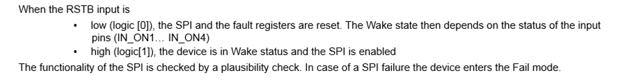

isaacavila
Hi Jashan,
RSTB should be in high state (according to datasheet):
Isaac

isaacavila
Hi Jashan,
Yes, In this case first received byte is MSB and second is LSB.
Remember that every time you send a data through MOSI pin, you are receiving another byte on MISO pin, that is why your program did not receive second byte (the first received byte was replaced by the second one.)
I think this final function can now receive and send 2 bytes for communicating with your slave device.
Isaac
