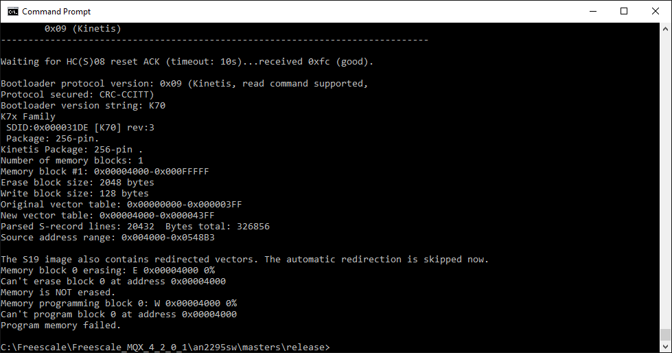

I have expanded my project and now the bootloader code is having problem. It stops at the first erase operation. Any tips?
Here the boot working:
here the boot not working:
Hi Andrey,
try to check use the following S19 testing file and let me know.
