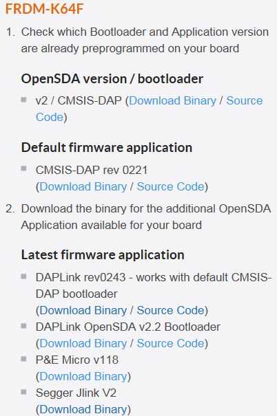

Thank you for responding.  After I plugged in the board, no LED blinking or BOOTLOADER yet, then I press reset and the BOOTLOADER in windows explorer shows up as shown in your image with the LED blinking slowly.
I'm following the instructions in your link, at the bottom where there's a link that says "Get the latest DapLink firmware for FRDM-K64F here", which takes me to a page with different firmware files - DAPLink rev0243, DAPLink OpenSDA v2.2, P&E Micro, and Segger JLink.  Which one do I need to download for dragging and dropping onto the BOOTLOADER?

jorge_a_vazquez
Hi Kameron Yiu
Sorry for the late reply. In the page that I share you in my last response you can find in the bottom of the page the label "rev 0226 [ ... ] ", if you click in the three dots, it will download the file that you need.
Hope this information could help.
