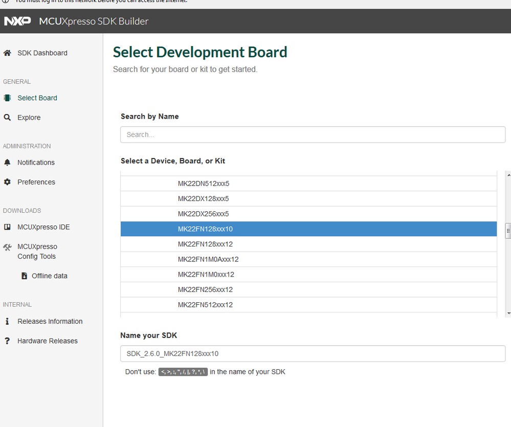

I am using IAR 8.11, and I want to do a USB mass storage, I followed the example generated by the MCUXpresso SDK "usb_device_msc_ramdisk". My problem is that the example is for MK22FN512VLH12, and I am using the MCU MK22FN128VLL10, I made the clock settings, and all the settings to use the k22128VLL10, but the compiler sends me the following error:  Error [Lp011]: section placement failed unable to allocate space for sections / blocks with a total estimated minimum size of 0x666c bytes (max align 0x200) in <[0x1fffe000-0x1fffffff], [0x20000000-0x20003bff]> (total uncommitted space 0x5c00).             Uncommitted:             [0x1fffe000-0x1fffffff]: 0x2000             [0x20000000-0x20003bff]: 0x3c00   edit the file MK22FN128VLL10_flash.icf  Changing:  define symbol m_data_start = 0x1FFFE000; define symbol m_data_end = 0x1FFFFFFF;  define symbol m_data_2_start = 0x20000000; define symbol m_data_2_end = 0x20003FFF;  And the error disappears, but it does not debug properly. I don't know if I need an MCU with the same memory as the MCU 512, I'm a little confused, thank you very much

If you are using the MK22FN128VLL10, I suggest you download the related SDK code from this link:
https://mcuxpresso.nxp.com/en/select
Please generate the SDK_2.6.0_MK22FN128xxx10 code, and download it.
You will find the related icf and the header file in folder:
SDK_2.6.0_MK22FN128xxx10\devices
Please try it on your side.
