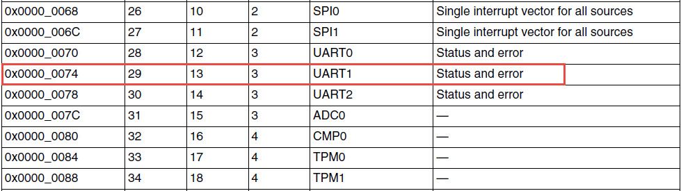

I am working on kl26z frdm board anf want to receive UART data on interrupt. I have written the following initialization code and ISR code but its not running succesfully. Please help me with a solution.

My UART1 is working but its not working on interrupt subroutine when it receive a character.

I was my fault i was enabling uart0_interrupt. Thanks for the help its working now.

I've had a brief look through the code you shared above, I think the root cause of this issue is interrupt channel assigns wrongly.
From the table 3-7 Interrupt vector assignments, we can find the IRQ of UART1 is 13, not 12.

Are you sure  "enable_irq(12);" is right ?
I checked the KL26 reference manual , the  UART1 IRQ is  13 .
