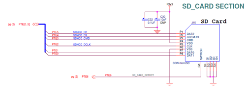

The schematic for SD card is shown below. The board uses SDHC module to communicate with SD card.
                                                 Figure 1. Figure 1.Schematic for SD card

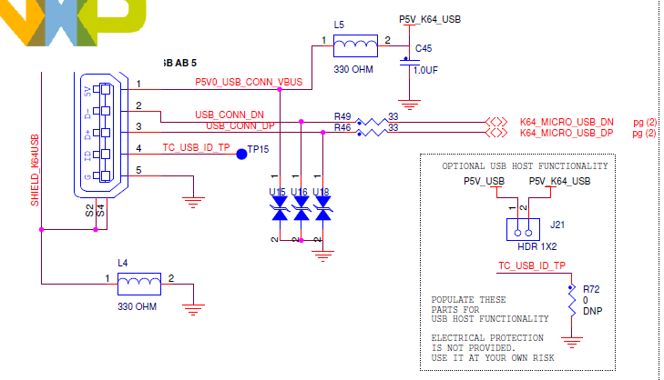

The schematic for USB is shown below.
                                                     Figure 2. Schematic of USB

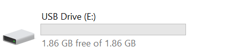

In main code, the program will initialize the usb, sd and fatfs. Then the computer will communicate will MCU. Finally, PC will recognize the mcu as a u-disk.
               Figure 3.u-disk

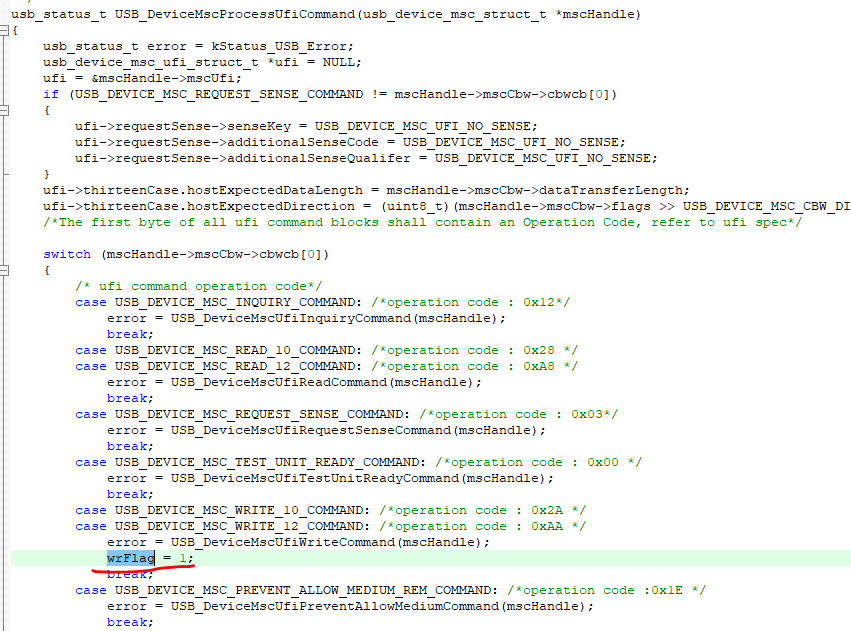

Use a variable “wrFlag” to check the modification of the file. When we put file into the u-disk, this variable will be set.
                                          Figure 4. Modification of flag
When this variable is set, the program will open the “a000.bin”. Then update the application. Finally, go to the application.
                     Figure 5. Update the application

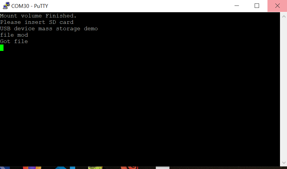

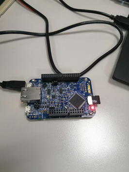

  •     Download this bootloader
  •     Prepare a user application program. We use the “led blinky” as an example. Use it to generate the binary file. Name it as “a000.bin”. Put it into the u-disk. You will see some log in the uart.
  •     The application will execute automatically
