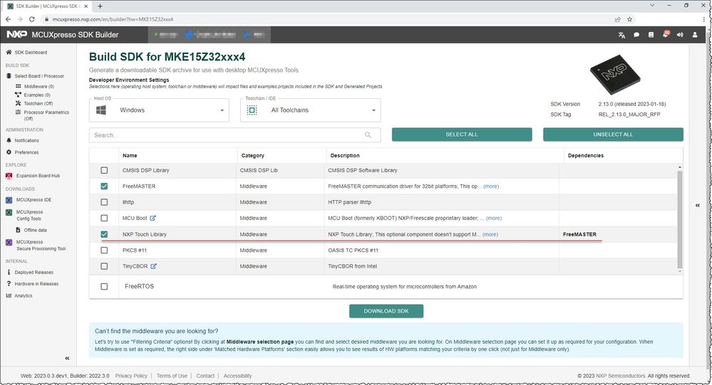

I am trying to implement Touch sensor for the MKE15Z32 but there is no sample project from the available SDKs on SDK builder except for the MKE15Z256xxx7 (Freedom board).
Is there any snippet or sample available for me to work on this one?

Robin_Shen
Hi Areshiones,
Please select NXP Touch Library when building MCUXpresso SDK for MKE15Z32xxx4.

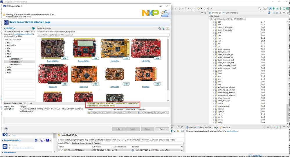

Yes. There is a warning: SDK Import Wizard is not available for device SDKs Please select an item with board.
Please refer to the examples of SDK_2_13_0_FRDM-KE16Z. (Freedom Development Platform for 48MHz KE1xZ64/32 MCUs)

Areshiones
Yes,
I did that, it is better to state the following:
- Import the fsl_tsi_v5.h into your project
- You need to configure the pins and clock accordingly
- Utilizing the proper TSI_config and TSI_key files do help for the implementation
After that, it should work.
