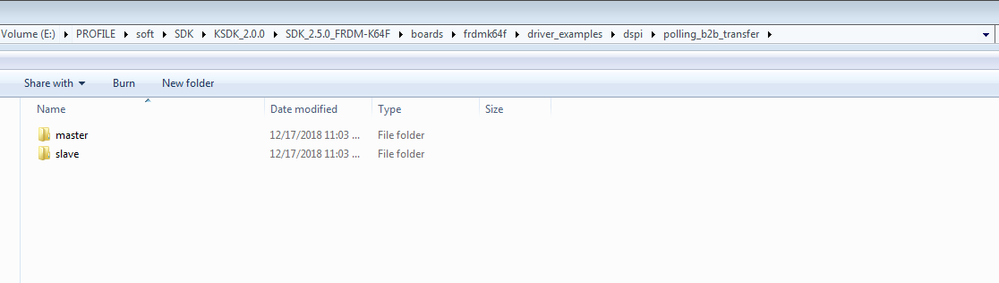

   You can find the SPI master and slave code from this folder:
SDK_2.5.0_FRDM-K64F\boards\frdmk64f\driver_examples\dspi\polling_b2b_transfer

Thank you for your reply. I have tried to import the code in MCUXpresso the project was unable to import. also tried to import XML file that was also unsuccessful.
