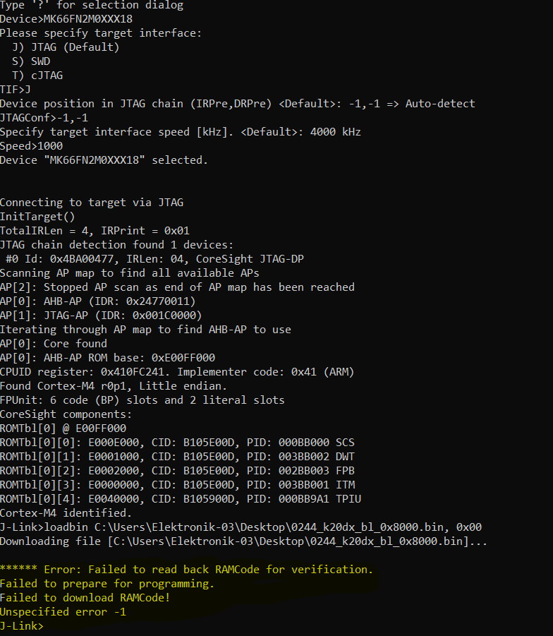

My FRDM-K66F board got bricked and I have a problem trying to reprogram the bootloader using Segger J-Link.

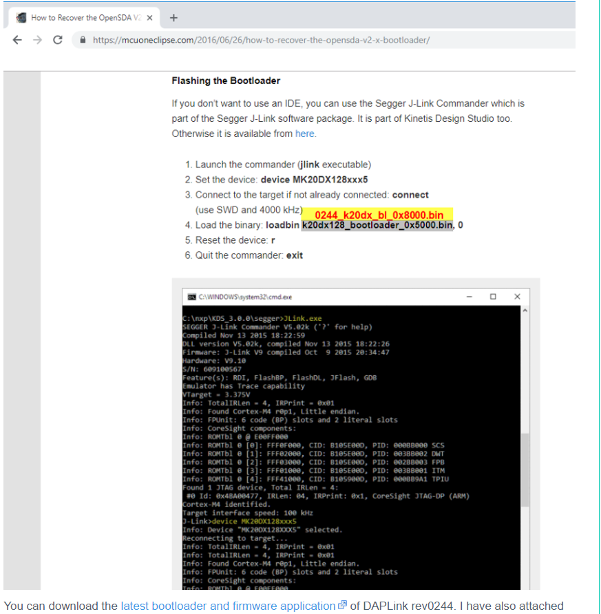

the bootloader openSDA v2.2 is downloaded from  openSDA 2.2 and the following method is used to load the bootloader
I am using Segger J-Link Commander for flashing the bootloader, When I attempt to load the bin file I get the following error message  "Failed to read back RAMCODE for verification" from JLink Commander.
Can anyone help? Thanks in Advance.
2,356 Views
r14713
Looks like you are trying to flash the bootloader image to the K66 and not the K20  (where you need to flash it)
To connect the J-Link to the K20  you can access through the "OpenSDAv2 debug" header.
See page 4 of:
https://www.nxp.com/docs/en/user-guide/FRDMK66FUG.pdf
The 2 headers are similar.  1 is for the K20, the other for K66.

Thanks Gary Anderson, it's working.
