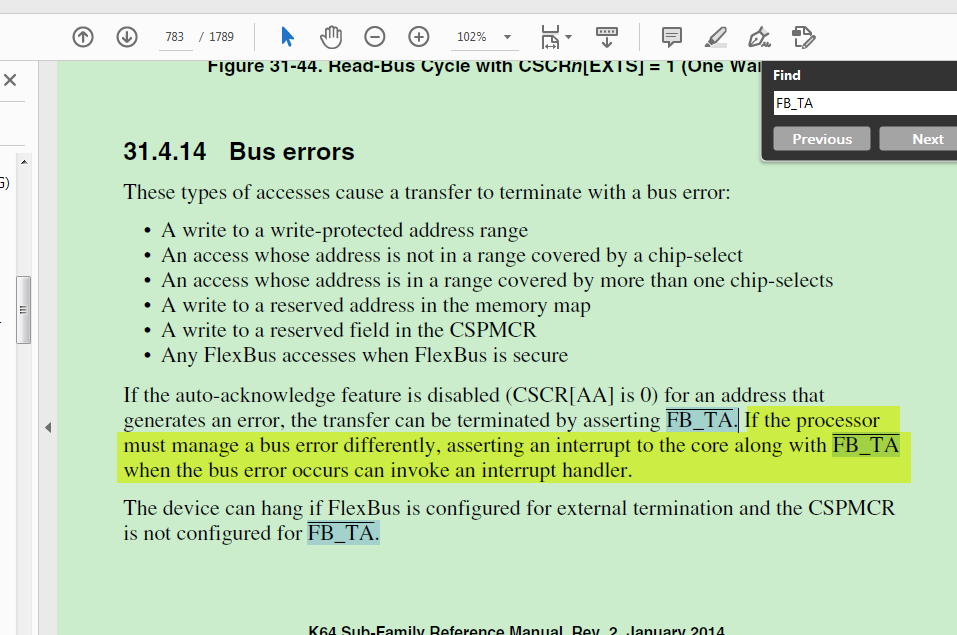

I am using the Flexbus on a k64 to communicate with an FPGA. I am using the FB_TA signal as the primary way to terminate transactions but I do have autoAcknowledge enabled and waitStates set to 63 as sort of a fallback mechanism in case the bus were to hang. My question is, is there a bit in a register somewhere or an interrupt that can be configured to inform me that a FB_TA signal was internally generated?

   About FB_TA signal interrupt or the register, I didn't find the specific status register.
   About the interrupt, I just find this description:
Another way, maybe you can connect FB_TA to another GPIO input pin which can support interrupt, then use the GPIO interrupt to detect it.
Wish it helps you!.
Kerry

Hi Kerry, I had seen the part that you highlighted prior to asking the question. The problem is that FB_TA needs to be externally generated and it is working, but if there ever is a problem I wouldn't know it directly because the auto-acknowledge would happen without any indication.

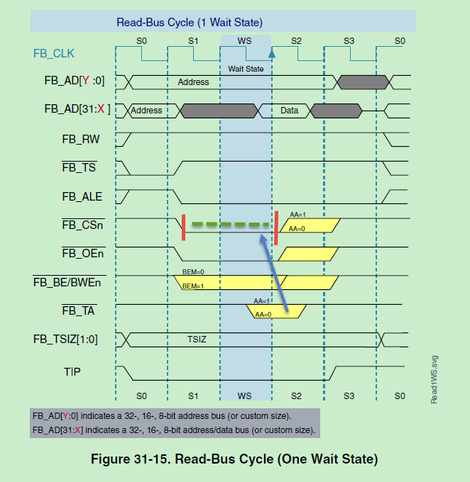

You don't seem to be understanding the question. I know that AA works. I know that having the FB_TA driven by an external device works. I know if AA is enabled and the external device takes longer than 63 clocks to drive FB_TA that FB_TA will be internally generated. I want to know if that is happening.

  Sorry for my later reply, today, I help you to check with our expert who is familiar with flexbus.
  He told me, the flexBus IP really didn't have the detail register to identify the internal FB_TA(auto-acknowleage happens), but you can detect the FB_CS pin:
When the FB_CS is happens, you can use your wait states time, after the wait states time is finished, you can consider the FB_TA is generated. Maybe it is not very precise, but it should be enough to use it.
Wish it helps you!
