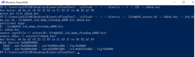

2.1 Generate key
The elftosb tool can generate a key. But of course, you can take any string as key.
2.2 Image encryption
Use the key to encrypt application image. Here is the bd file.

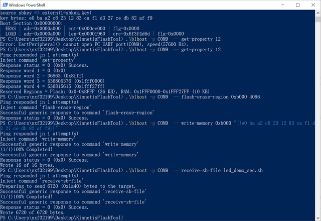

2.3 Download key and image
Connect FRDM-K64F openSDA usb port. Then download key and image.
2.4 Download key with KinetisFlashTool
Use keyboard to input key is really annoying. There is a GUI tool named KinetisFlashTool which can download image same as blhost.exe. To download encrypted image by this tool, we can make a sb file to download key first. Here is the bd file.
sources {
section (0) {
       erase 0xb000..0xc000;
       load {{E0BAA2C8231283CAF1D327CEDB82AFF9}} > 0xb000;
Using elftosb to generate the sb file. The elftosb command line is as below
\>Elftosb -V -c program_key.bd -o program_key.sb
This sb file should be download at first, then download the encrypted application image. When customer want to download security image via USB MSC or HID, this is the only way to download key. There is a limitation in those bootloader which version is lower or equal to v2.7.0. MSC function and HID function can’t be enabled together. Otherwise bootloader will fail when copy encrypted sb file to MSC disk.

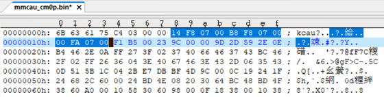

The ROM bootloader hasn’t encryption algorithm. Application should include algorithm code and assign the address to bootloader, or preprogram BCA table and MMCAU code into flash.
You can find MMCAU code (mmcau_cm0p.bin) and BCA(BCA_mmcau_cm0p.bin) table in MCUBoot2.0.0 package.
Before you program these code into flash, new address must be written into it. For example, we put MMCAU code into 0x7f800, then we should modify the BCA table as below
And then, according this new address, modify the MMCAU_function_info structure in mmcau_cm0p.bin.
After that, download BCA to 0x3c0 and mmcau_cm0p.bin to 0x7f800.

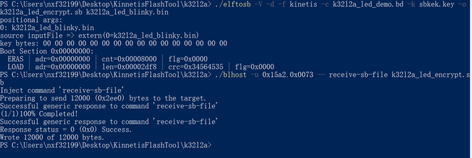

3.3 Encrypt the image and download
The bd file in K64 example can be reused, just need to change the image address to 0x00.
Press the reset button, after 5 second, the led will blink.
