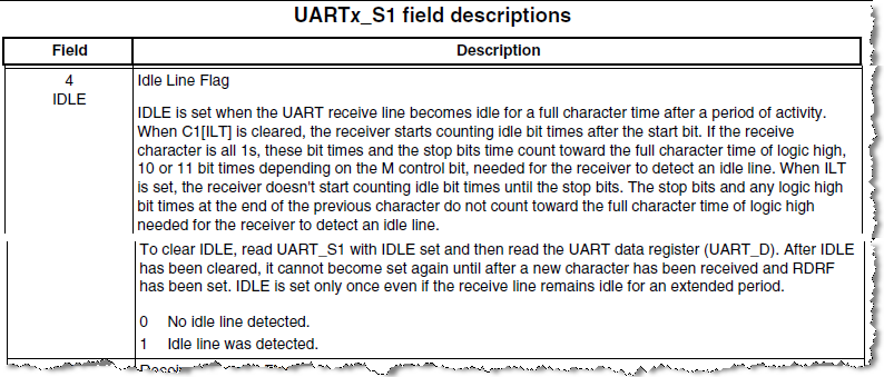

Robin_Shen
Hi Bruce,
Please check the Idle Line Type UARTx_C1[ILT] and UARTx_C2[ILIE].
I am not sure if you enable the kUART_IdleLineInterruptEnable?
The IDLE status flag includes logic that prevents it from getting set repeatedly when the RxD line remains idle for an extended period of time. IDLE is cleared by reading UART_S1 while UART_S1[IDLE] is set and then reading UART_D. After UART_S1[IDLE] has been cleared, it cannot become set again until the receiver has received at least one new character and has set UART_S1[RDRF].
Robin

bgraham
I added the line UART_EnableInterrupts(DEMO_UART, kUART_IdleLineInterruptEnable); before the call to UART_TransferStartRingBuffer().
After UART_UserCallback() kStatus_UART_RxHardwareOverrun, I checked the registers.
UART1 C2.ILIE is 1
UART1 S1.IDLE is 0
See registers below.
See code below.
Since C2.ILIE is set, why would UART_UserCallback() never got called with kStatus_UART_RxIdle?
Bruce
