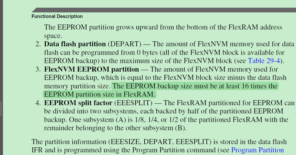

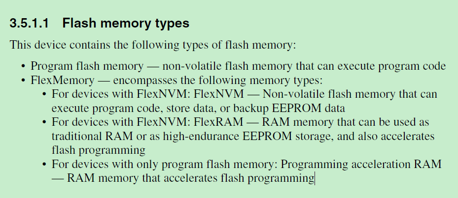

   Please check the reference manual K22P64M120SF5RM.pdf, page 93, you will find this description:
   If the chip don't have the FlexNVM, it doesn't have the EEPROM function, because EERPOM need to use FlexRAM and FlexNVM together, FlexNVM is used as the EEPROM backup memory.
  Now, please go to reference manual page 634:
   When do EEPROM partition, the EEPROM backup size must be at leat 16 times the EEPROM partition size in FlexRAM, EEPROM is also the hardware character, the chip doesn't have  the FLexNVM module, it also doesn't have EERPOM.
   Now, to your chip, just two way if you want to use the eeprom function: 1. change chip to MK22FX512VLH12, this chip have FlexNVM, 2, use flash to emulate the EEPROM function, actually it is using flash to store data.

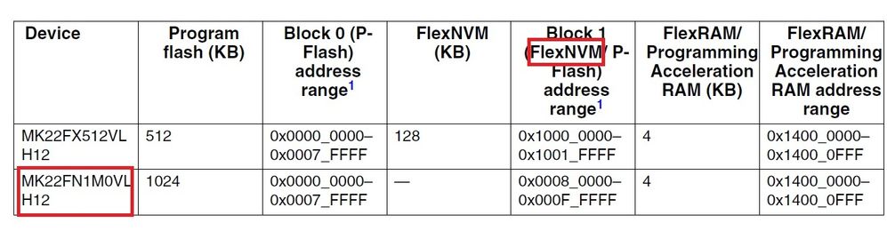

kent_gu
Jingjing,
Thanks a lot for your quick response, but I found the datasheet say that MK22FN1M0VLH12 have 256K FlexNVM as above picture, also "
Using Kinetis® FlexMemory as enhanced EEPROM
" describe the EEPROM using with Flexmemory.
I am confused?
Kent

Hi Kent,
  You are misunderstanding it.
  Please see the FlexNVM item, it's none, all the kinetis K series chip with FN doesn't contain FlexNVM, just FX has the FlexNVM module, you can find K22FX512VLH12 have 128KB FlexNVM.
  So, if you really want to use EEPROM, please choose the chip have FX which contains FLexNVM module.
