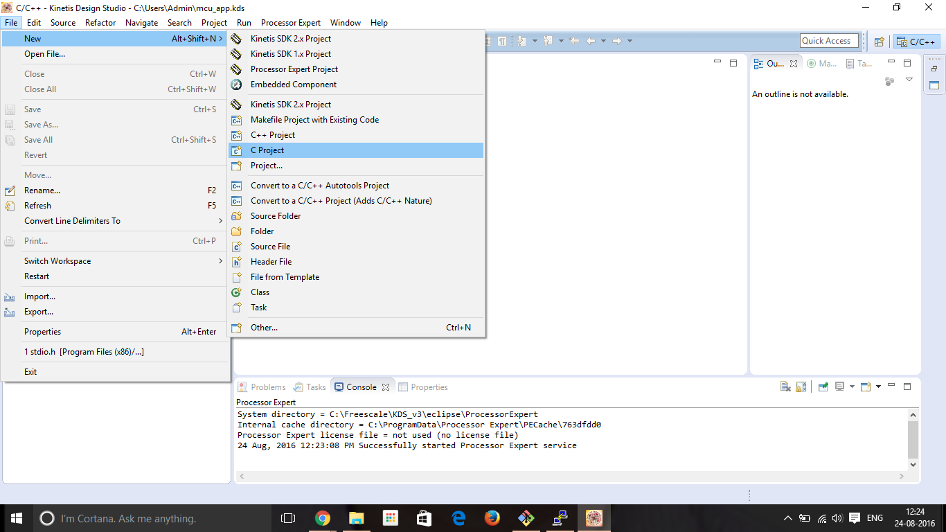

     I want to use Semihoosting Working on a Non-processor expert project.I have created a project from scratch and I have posted The screenshot of each and every step and the problems I faced in it.I have also attached the Project .In this i have selected the Target Processor as ARM Cortex-M0plus

vigneshbalaji
Senior Contributor I
   Hi Erich,
                 I am using TRK-KEA-128 Board which is not supported under KDS SDK Package.For which I have attached the Screenshot and the Question that I asked in the forum Why KSDK is not supporting KEA-128 Still??? .So I was not able to follow this post of yours  https://mcuoneclipse.com/2016/08/06/semihosting-again-with-nxp-kinetis-sdk-v2-0/ but I followed the second post https://mcuoneclipse.com/2015/05/27/semihosting-for-kinetis-design-studio-v3-0-0-and-gnu-arm-embedde... and created a C project and attached the Project in this thread.
