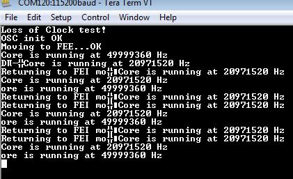

I've tested this example by using TWR-K21D50M but using the external reference clock from TWR-SER instead of 8-MHz resonator and it worked well. This is the code that I used:
int main(void) {
    /* Init board hardware. */
    BOARD_InitPins();
    //BOARD_BootClockRUN();
    BOARD_InitDebugConsole();
    /* Add your code here */
    PRINTF("Loss of Clock test!\r\n");
    osc_config_t oscConfig;
    oscConfig.freq = 50000000;
    oscConfig.capLoad = 0U;
    oscConfig.workMode = kOSC_ModeExt;
    oscConfig.oscerConfig.enableMode = 0;
    CLOCK_InitOsc0(&oscConfig);
    CLOCK_SetXtal0Freq(oscConfig.freq);
    PRINTF("OSC init OK\r\n");
    PRINTF("Moving to FEE.....");
    /* Set clock divider to safe value to switch mode */
    CLOCK_SetSimSafeDivs();
    CLOCK_SetFeeMode(6, kMCG_Dmx32Default, kMCG_DrsMid, NULL);
    g_bFeiModeOn = 0;
    DbgConsole_Deinit();
    PRINTF("OK\r\n");
    PRINTF("Core is running at %d Hz\r\n", CLOCK_GetCoreSysClkFreq());
    CLOCK_SetOsc0MonitorMode(kMCG_MonitorInt);
    NVIC_EnableIRQ(MCG_IRQn);
    for (;;) { /* Infinite loop to avoid leaving the main function */
        if (g_bFeiModeOn)
            delay();
            g_bFeiModeOn = 0;
        /* something to use as a breakpoint stop while looping */
void MCG_IRQHandler(void) {
    CLOCK_SetOsc0MonitorMode(kMCG_MonitorNone);
    NVIC_DisableIRQ(MCG_IRQn);
    PRINTF("Returning to FEI mode");
    CLOCK_SetFeiMode(kMCG_Dmx32Default, kMCG_DrsLow, NULL);
    g_bFeiModeOn = 1;
When I debugged the project, I also could see that IREFST field of register MCG_S remains set to '0' but when I ran and used debug console I could see that transitions where done correctly.
I hope this helps!
Isaac
