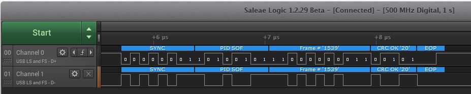

baldurthorgilss
Hi Alexis
Turns out that you had the solution
When I managed to delete the windows audio driver properly (it appeared in two groups in device manager) it turned out that my code was working all the time.
My conclusion is:
that logic analyzers might not reflect the actual situation (the way a root hub would understand the signals) as they flip the state by a single level but USB is defined upper and lower levels.
Wireshark turned out just as good a tool in my case. It reflects the actual understanding of the USB packages.
Also deleting a driver is not trivial, it might appear in more than one group under device manager and in this case it must be deleted in all groups.

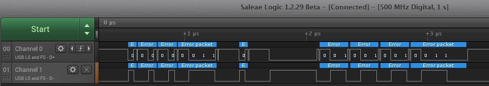

baldurthorgilss
Hi Alexis
I'm still struggling with this problem. At the moment I have doopts that my logic analyzer is interpreting the signals the way the PC does so I have involved Wireshark software. Here is the package sequence for the original version of the generator:

When I try my own version I get the following

In my quest to understand the problem I got me a USB analyzer. The USB protocol is of cause extensive, but I start slowly. One common thing is the frame rate package sent every 1 ms. Checking my mouse I got an image like the following
When I run the generator project on my NXP board unchanged from the example I get this every 1 ms (otherwise same setup on logic analyzer):
Almost every frame package has error!
In spite of this large amount of errors, I can still hear the generator sound in my PC.
This is the original example, I have not changed it. Why has my frame (and other) packages error (it can easily be seen e.g. in the D+ signal how strange it looks)? I have tested a number of other devices, no other device behave like this.
My ultimate goal is to understand why my 16-bit, 16kHz signal is not working as streaming audio, but that error drowns in these errors. I need to fix this first.
I would be happy for any comment.
