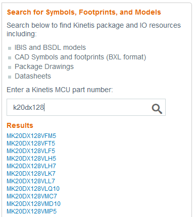

On Kinetis Symbols, Footprints and Models|NXP  I search for my device:
I select the device and download the BXL file:
Download BXL File
