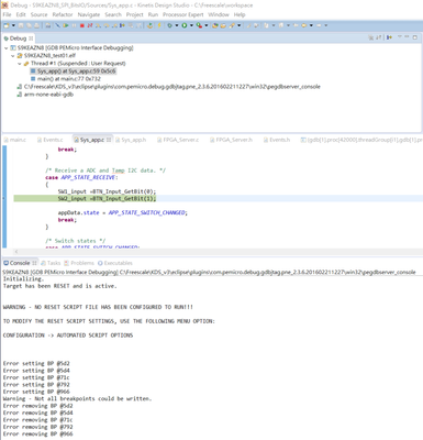

Dear
I am using TRK-KEA8 with KDSv3.2.0.
The original Debug mode was normal, but when I created a new subroutine, I couldn't enter the Debug mode normally.

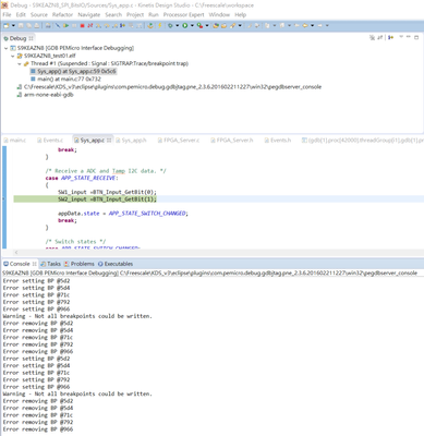

The following message appears repeatedly in the console:
Error setting BP @5d2
Error setting BP @5d4
Error setting BP @71c
Error setting BP @792
Error setting BP @966
Warning - Not all breakpoints could be written.
Error removing BP @5d2
Error removing BP @5d4
Error removing BP @71c
Error removing BP @792
Error removing BP @966
The program can flash TRK-KEA8 normally, but it cannot be used in Debug mode.
Has anyone encountered a similar problem?

I think, I have found the answer.
region "m_text" overflowed ____ bytes
