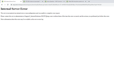

I have tried downloading mbedTLS library from the given link, but the download failed with following error
Link: https://www.nxp.com/design/designs/software-development-kit-for-kinetis-mcus:KINETIS-SDK

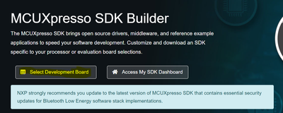

You could try downloading it from here: Welcome | MCUXpresso SDK Builder.
Please follow the next steps:

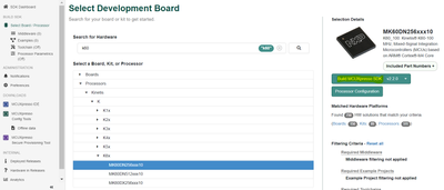

  • Click on Select Development Board
  • Search for the board or microcontroller you need, select it and click on Build MCUXpresso SDK

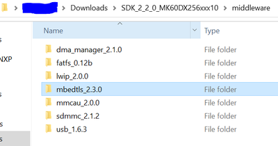

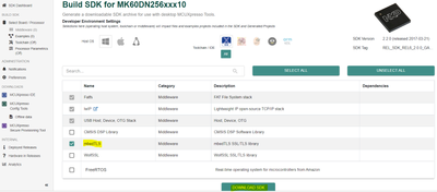

  • Choose your OS and IDE you are using, and click on the mbedTLS library for including it on the download. Finally click on Download SDK.
  • After download it you can search for the mbedTLS library in middleware
