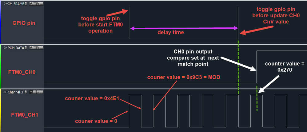

Three test signals:
FTM0_CH0 pin as output compare pin will generate square signal with 1.33KHz .
FTM0_CH1 pin generate 24KHz Edge-Aligned PWM signal(High-true pulses (clear Output on match)) with 50% duty cycle as FTM counter monitor.
When FTM counter change, the FTM0_CH1 will toggle to output high voltage.

During FTM0 module initialization, set the FTM0_CH0 pin output compare value to 0xA00 (more than MOD register value (0x9C3)) with below code:
Set the CnV value more than MOD register is to avoid the output compare be set during at start.
After that,  enable FTM0 counter and toggle GPIO pin to set a mark:
After delay, toggle GPIO pin and update CnV register to 0x270 (the match point is half of the PWM high voltage).
The actual signal is :

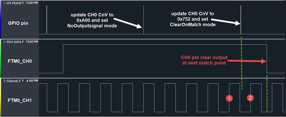

After the first CH0 output compare set match, before set CH0 pin clear on match.

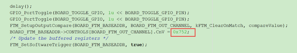

It need to keep the CH0 pin with same output compare mode and set CnV back to 0xA00 (more than MOD) again with below code:
Then we set CH0 with clear on match mode and update CnV value to 0x752 (middle of CH1 PWM low voltage):
The actual signal is:
With the similar code, before next CH0 set on match, it need to keep the CH0 pin with same match compare mode setting and CnV change back to 0xA00 (more than MOD).
The actual signal is below:
Note: During the output compare signal compare mode set/clear change phase, it need to keep previous output compare mode setting, please don't using kFTM_NoOutputSignal setting at code. Otherwise, the output compare signal will exist decay:
