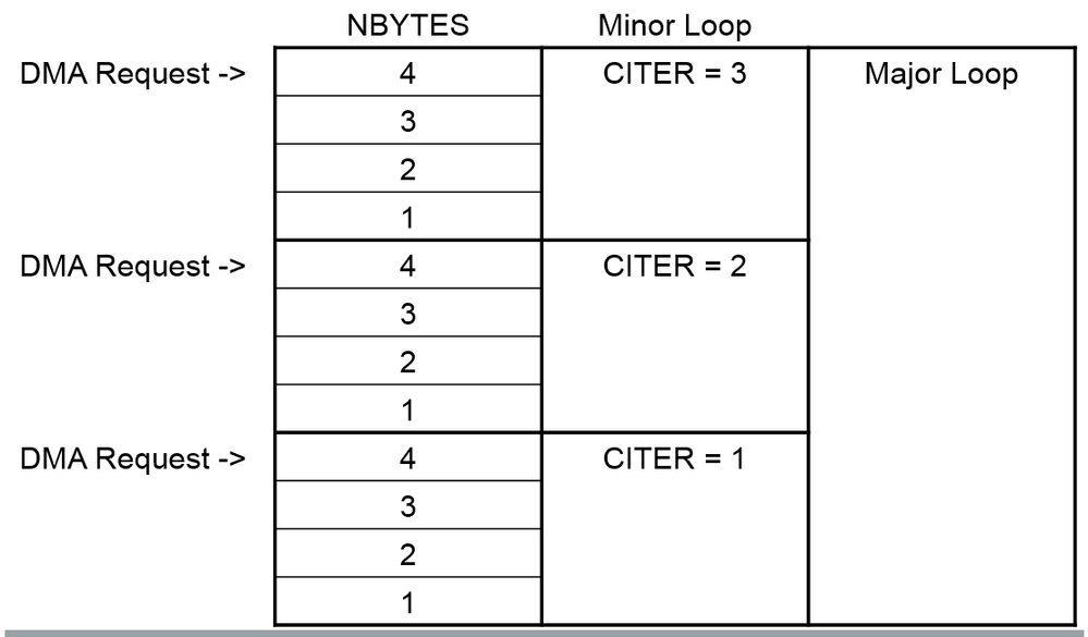

I'm building an application where I want to have a large RX buffer off UART1 on a K20D7.
I've created a DMA transfer from UART1 using the configuration code below. The problem I see is determining whether there has been a buffer overflow. I'm also unclear on the exact operation of DMA_TCD0_DADDR.
I'm thinking of DMA_TCD0_DADDR as a head pointer on a circular buffer. Does the DMA actually update the DADDR in a way that I can read from to determine where the next byte will be stored?
My approach is that I'll have a tail pointer to pull data off the buffer. If the tail and DADDR are the same, then nothing is in the buffer.
The only problem is when DADDR laps the tail pointer. As far as I can tell, there's no way for me to detect this.
Suggestions? This must be a relatively common style of serial port.. perhaps there's a better implementation approach?
thanks!
Rudy

Hui_Ma
Hi Justin,
I check your eDMA setting only use one major loop for one minor loop.
I would recommend you to use below eDMA setting, one major loop with more minor loop.
Each minor loop could transfer one byte from UART1 data to RX buffer.
It could set one major loop with N(buffer byte size) minor loop, each UART receive will transfer one byte data to RX buffer.
Customer could read DMA_TCDn_BITER_ELINKNO [BITER] bits value to check how many bytes could be load into the RX buffer.
BTW: I check below code with problem:
DMA_TCD0_ATTR = DMA_ATTR_SMOD(0) | DMA_ATTR_SSIZE(0)    // source does not iterate - no modulo, source is a byte in size,
  | DMA_ATTR_DMOD(0) | DMA_ATTR_DSIZE(10); // destination is a byte, 1 kB of buffer space, address must align with a 1k boundary
The DMA_ATTR_DSIZE value also should be 0.
Wish it helps.
Ma Hui
