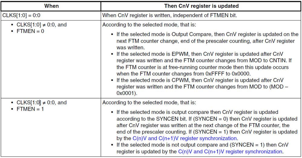

And I'd like to suggest you'd better revise the C(n)V update operation in reference manual.

No, this will not work. I need *every* pulse to last until comparator output rising-edge. Loading a different CnV value is a) too slow, even using DMA, b) doesn't solve much, because I'd have to load a 0 to make sure to cut the pulse short, and then I'd have to somehow make sure the output becomes high in the next PWM period.
Never mind. I don't think this can be done with Kinetis peripherals.

According to your response, Yes, I think the FTM module is incapable of this implemention.
