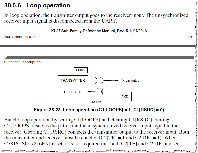

And make sure you are not using '38.5.6 Loop operation' mode.

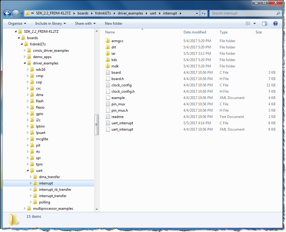

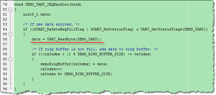

I test the uart interrupt demo in SDK_2.2_FRDM-KL27Z with FRDM-KL27Z board. (...SDK_2.2_FRDM-KL27Z\boards\frdmkl27z\driver_examples\uart\interrupt)
I can read the data from UAT2_D reg after I send data using UART Terminal port.

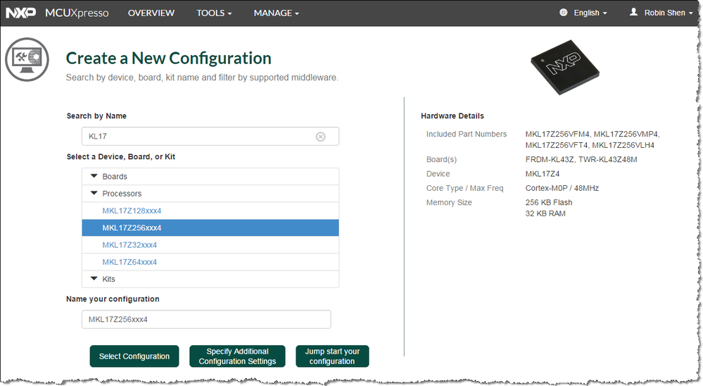

You can download and test that demo in SDK_2.2_MKL17Z.
