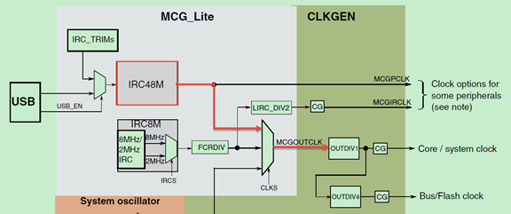

The demo is based on FRDM-KL03Z board, using internal IRC48M clock as system and bus clock source. There doesn’t need external clock source.

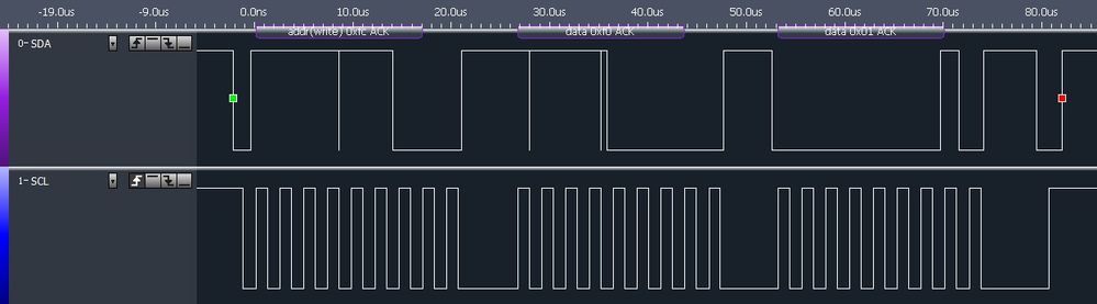

  2. I2C master start to configure SPI interface
     I2C to SPI bridge board I2C address is 0x7E.

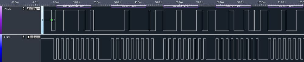

   I2C master write 10bytes to SPI slave, it will send 11bytes (includes one function ID 0x01). The first data is 0xAA and the last data is 0x22.
   After I2C to SPI Bridge receive the data, it will send 10bytes to SPI slave.

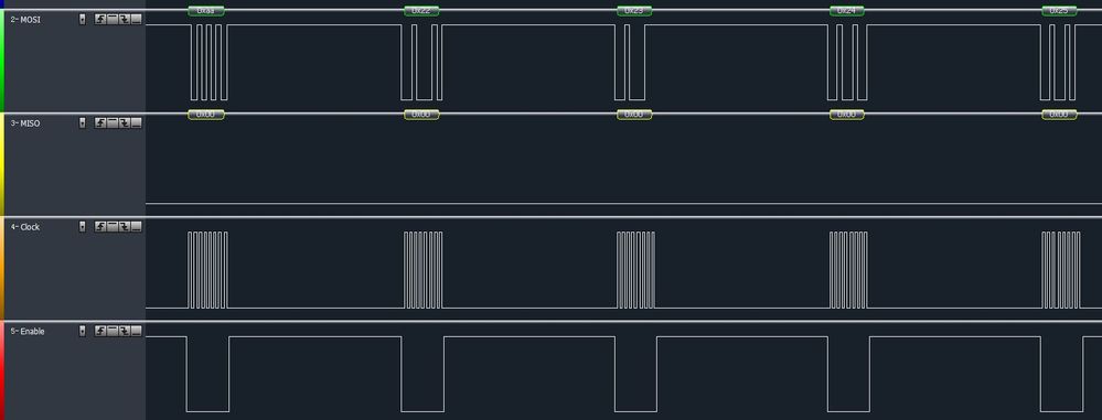

     I2C to SPI Bridge receive 10 bytes
    I2C to SPI Bridge send 10bytes to SPI slave

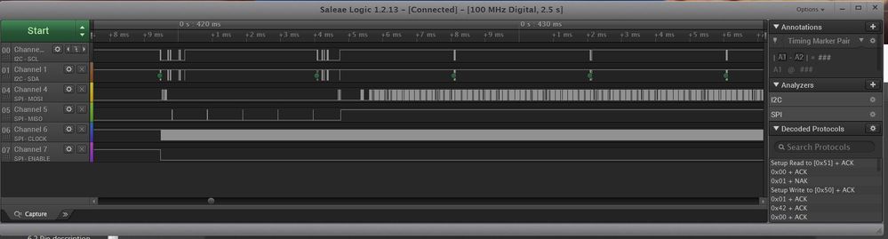

when I use the chip I can only send 12 IC2 bytes at once (Address + FunctionID + data).
If I send more than 12 Bytes the chip pull the clock low, but not back (clock stretching).
Sometimes I get no acknowledge for the IC.
The IC has a buffer of 200 bytes but I can use only 10 bytes.
On you pictures, I see that you send only 12 bytes. (you send only 10 data bytes).
Do you have the same issue like me?

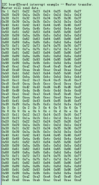

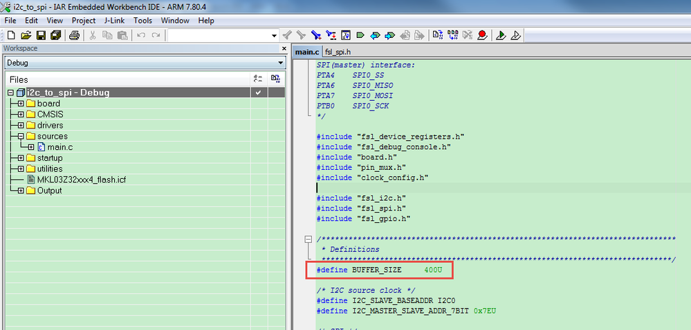

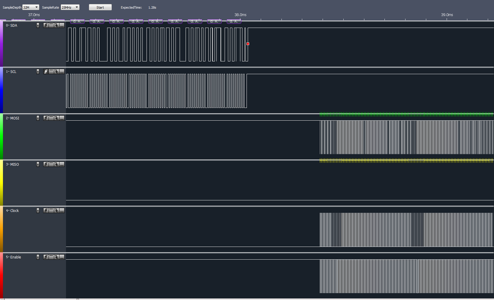

I had tested the data buffer with 400 bytes.
The I2C master send 400 bytes to I2C to SPI bridge without any problem, the SPI slave could get those 398 bytes sent from I2C master.

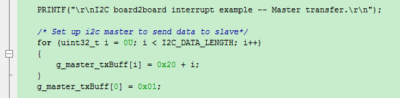

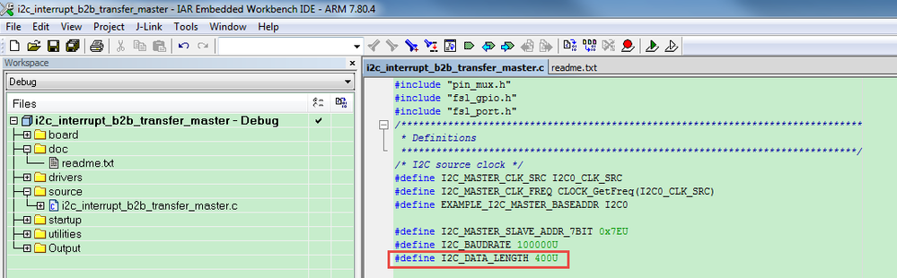

I am using KL03 simulate the SC18IS602B chip and extend the data buffer to 400bytes.
Please check the i2c-to-spi code:

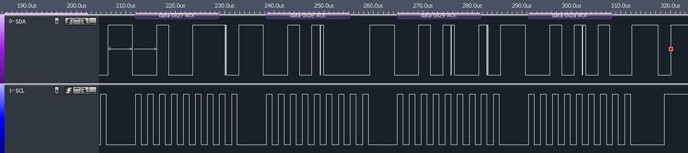

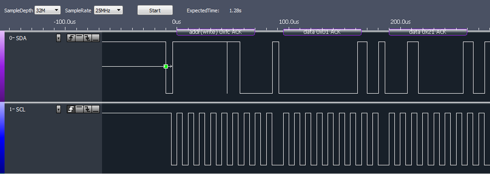

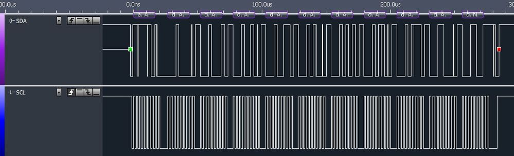

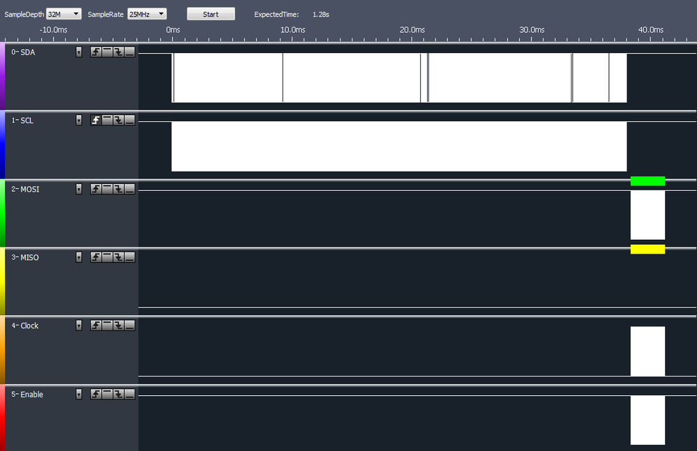

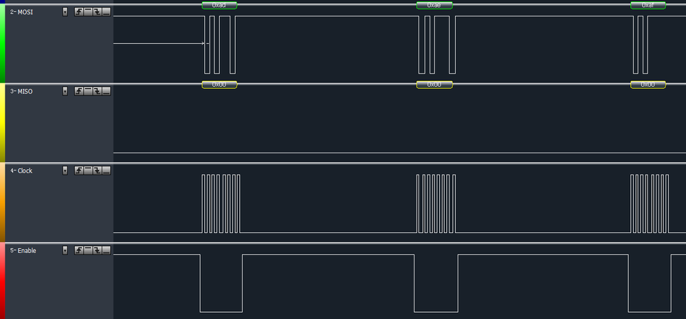

And I do a test to send 400 bytes from I2C master, which works normally as below pictures show:

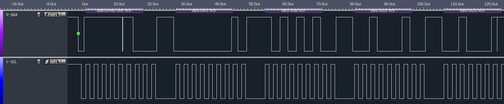

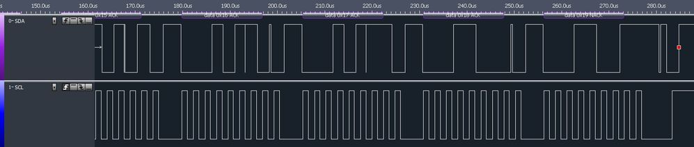

I2C data start with 0x1, 0x21
I2C data stop with 0xad, 0xae, 0xaf

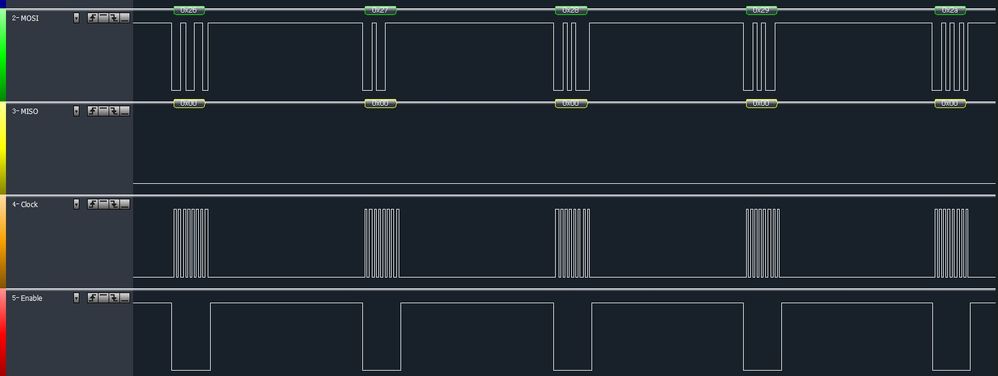

SPI master send data start with 0x21, 0x22 ... :

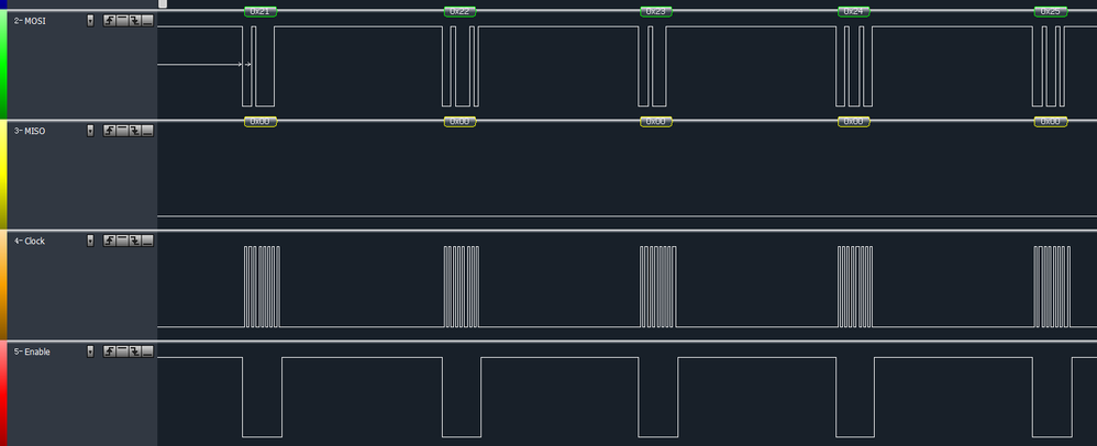

SPI master send data stop with 0xad, 0xae and 0xaf:
Thank you for the attention.

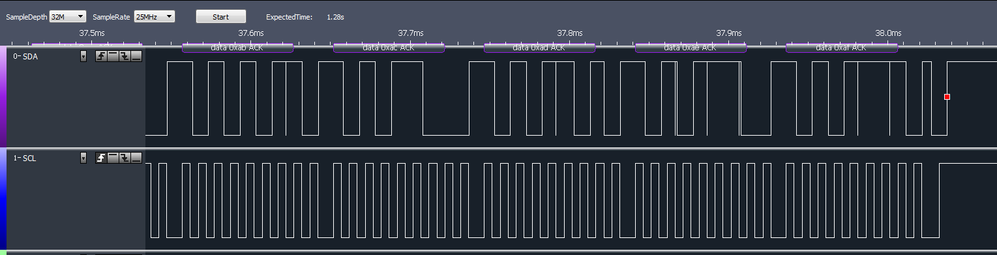

I can configure the chip but get no clock or data when i send address+functionid+data.  Any ideas would be welcome.  Im using arduino as controller.
Please check the SPI pins related configure.

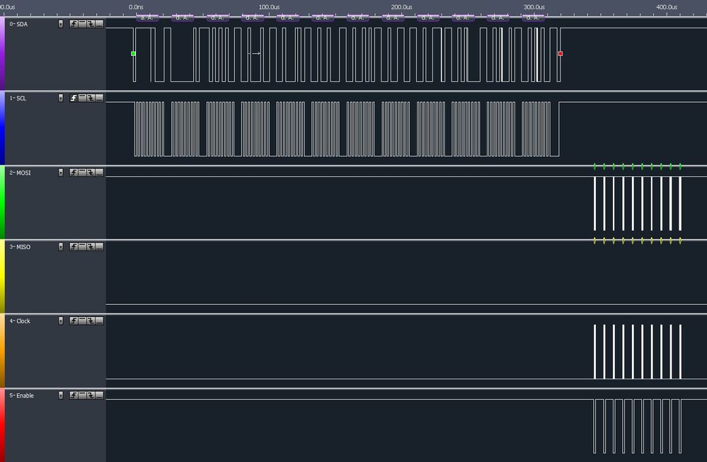

I can configure this chip and it will run for some time and then it stops responding to I2C commands and the SPI bus appears to stop working correctly.  No MISO data and the clock rate changes from the 460 kHz that I set it to to 1.8 MHz.  Here is what the data looks like when it failsLogic Analyser screen shot.JPG
What's the SPI slave device you connected?
best regards,
Mike
