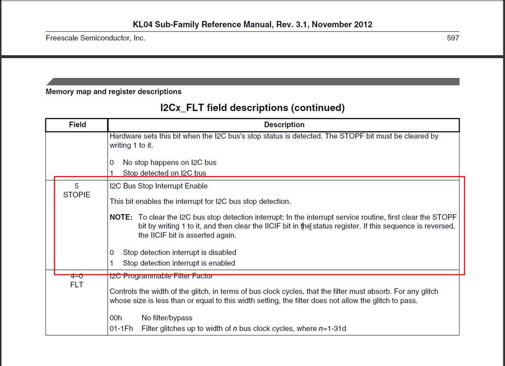

Hi Martin,
I found in RM there is some note for the STOPIE bit, please kindly refer to the following for details.
maybe your ISR has to be changed accordingly.
Hope that helps,
Kan
