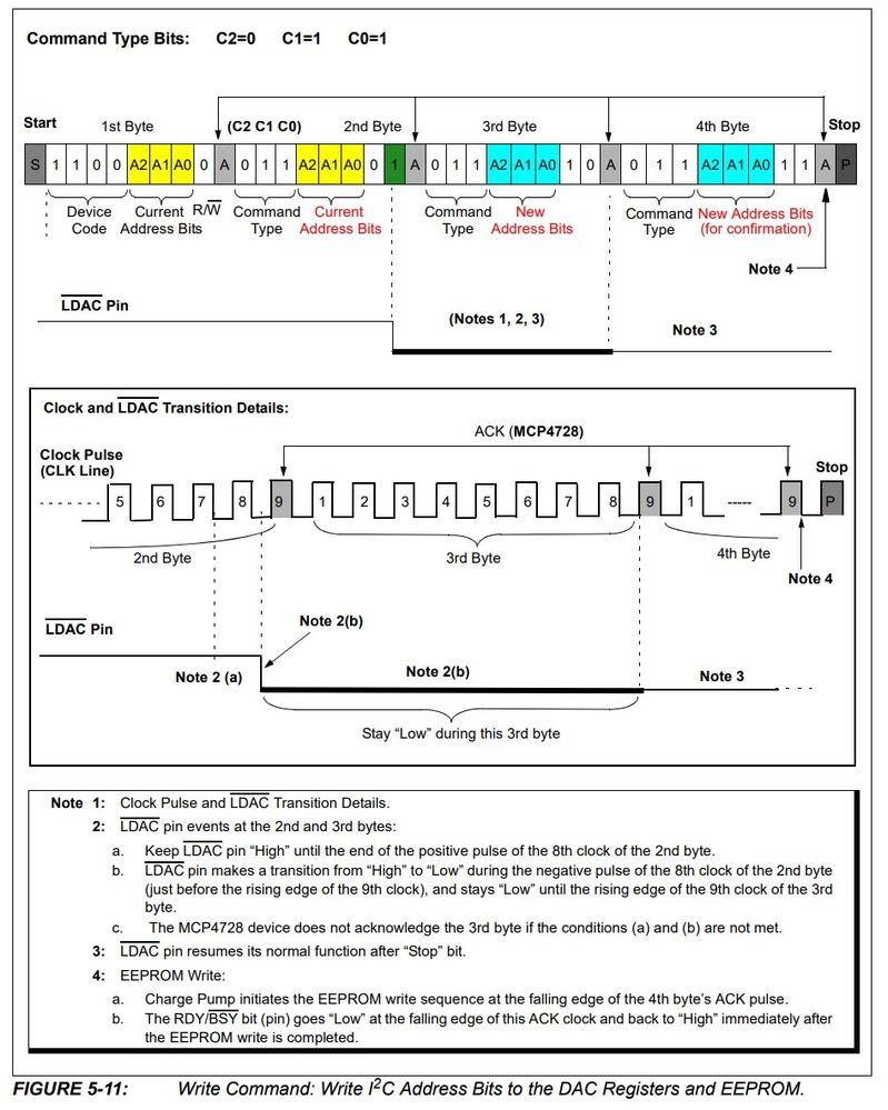

i have to set an address for a I2C slave (MCP 4728) connected to my MK22FN1M0...
Therefore i have change the state of another pin between bit 8 and bit 9.
My idea was to use the TCF interrupt with FACK enabled, because datasheet says:
"48.4.6.1 Byte transfer interrupt
The Transfer Complete Flag (TCF) bit is set at the falling edge of the ninth clock to
indicate the completion of a byte and acknowledgement transfer. When FACK is enabled,
TCF is then set at the falling edge of eighth clock to indicate the completion of byte."
I get the Interrupt at the 9th bit, but i cannot move the interrupt to the 8th bit.
Am i missing something?
Is FACK not changing TCF behaviour if not in SMBus receiver mode?
The behaviour i need is this:
LDAC Pin is on a separate I2C independent GPIO

You are correct! FACK does not change TCF behavior if not in SMBus mode.
