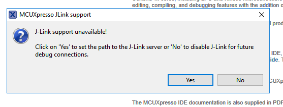

I completed a reinstall of MCUXpresso IDE v10.3.1 [Build 2233] [2019-02-20] and was able to recreate the problem.
The first time I try and debug the FRDM-KW41Z board I get this message:
I then had to manually find where the SEGGER directory is on my PC and I selected this file:
C:\Program Files\SEGGER\JLink_V642b\JLinkGDBServerCL.exe
Maybe someone can confirm if this is the correct selection here.
I also found out where I can change this option, should I need to change it:

Ok, with a bit of trial and error I figured this one out.
The first thing I had to do was browse and select the "JLinkRegistration.exe" file for the "J-Link Server executable" then "Apply and Close".
Then when I choose DEBUG it throws up a SEGGER registration screen. I filled in the details etc. and sent these off.
Now I return to Windows preference options and now choose the "JLinkGDBServerCL.exe" file and "Apply and Close"
Now when I choose DEBUG it finds the serial number and I enter the debug session.
Well, there you go. Who would have thought?
At least I'm now up to speed on MCUXpresso's JLink options now...
