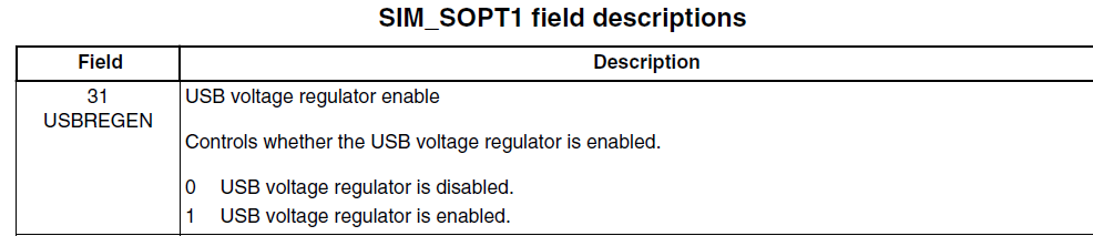

I am wondering how to set the USB voltage regulator to standby mode on the K22FX512VMC chip. We do not need the USB on the project, and would like to save as much power as possible. The reference manual only states that the mode is controlled by 'internal power mode signals'. I use KDS with Processor Expert to program on this project.

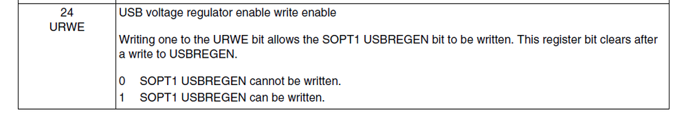

cutworth
Hi Gray,
You can disable USB regulator with SIM_SOPT1[USBREGEN] bit.
To allow writing to this bit, you need to write SIM_SOPT1CFG[URWE] bit first.
Hao

cutworth
Hi Gray,
Hao
