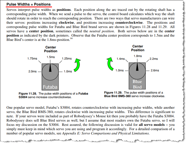

The typical pulse period is around 20 ms, which corresponds to a frequency of 50 Hz. (But you have configure frequency of 60kHz which may too high.)
The pulse width is generally the most important part of the interface, and that is what we intentionally vary to change the command to the servo. The general idea is simple: a pulse width of 1.5 ms is what we consider “neutral”; increasing the pulse width will make the servo go one way, and decreasing the pulse width will make the servo go the other way.(But you have configure 1% dutycycle which may too small.)
I am not sure what type Servo Motor are you using. For different Servo Motor, the Pulse Width of Center Position maybe different.
