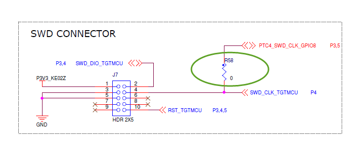

I was reading that Freescale board has (on-board) some pins (10) as SWD interface to program ke02 without OpenSDA. The User's Manual says "It is possible to isolate the KE02Z MCU from the OpenSDA circuit and use J7 to connect to an off-board MCU." Maybe I can connect the external debugger there...
Okay, if it's okay, I can program ke02 externaly.

1. About external debugger:
   It seems you already have the FRDM-KE02, it's OK.
   Give you a good news: our FRDM board's on board debugger also can debug the external chip or kinetis board.
   So, just follow me.
1) make the FRDM-KE02 as the external debugger.
  Download the JLINK firmware to your FRDM-KE02 board, just make your board debugger as the JLINK.
  Then check the following picture:
Remove the R58, then use J7 to connect to your external SWD interface.
Actually, R58 will determine the on board debugger to connect to the on board chip or the external chip.
If you connect the R58, SWD will connect to the on board KE02 chip.
If you disconnect the R58, SWD can connect to external KE02 chip with J7.
