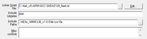

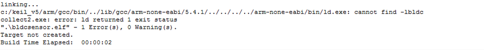

I try to transfer the bldc project in codewarrior to Keil,and I just found the ".a" files in the machine library after the installation; So in MDK,I change the complied environment with GCC,then I start to link these .a files,but there is always a problem with connectivity.
In keil Options for target,In Linker I did the following settings,libbldc is libbldc.a, add the link and compile the error shown above picture. What should I do to slove the problem of the .a link?

    Please try to modify include libraries from libblcd to blcd, then try again.

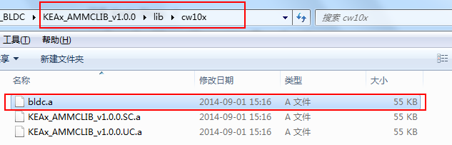

    Besides, you should make sure, libblcd.a in the folder:
   Then try again.

According to your method,I change the name of the .a file,but I think this just a name for the .a file,as long as the corresponding path file exists;also ,I checked the relevant folder where  the bldc.a file resides;
but the result of build is the same as before...
