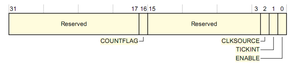

By summary, the SysTick is configured through four registers:
1. SysTick Control and Status(CSR): basic control of SysTick e.g. enable, clock source, interrupt or poll
COUNTFLAG: count-down flag, if down to 0, then this bit will be set to 1, otherwise, it will be 0.
CLKSOURCE:  when using internal core clock, it will be 1. If using external clock, it will be 0.
TICKINT: interrupt enabled when setting to 1.
ENABLE: counter enabled when setting to 1.

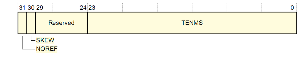

4.SysTick Calibration Value(CALIB): contain the number of ticks to generate a 10ms interval and other information, depending on the implementation.
TENMS: tick value for 10 ms.
