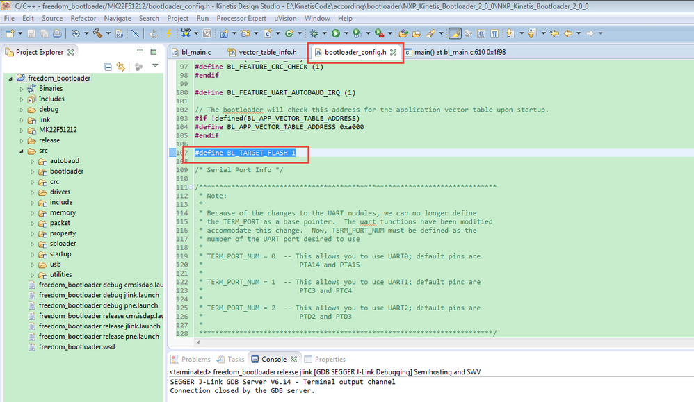

  1. Open \NXP_Kinetis_Bootloader_2_0_0\targets\MK22F51212  freedom_bootloader project
    You said, you are using the KDS project, the KDS project need to modify one point.
   Add this below code in bootloader_config.h
 #define BL_TARGET_FLASH 1
Just like this picture:

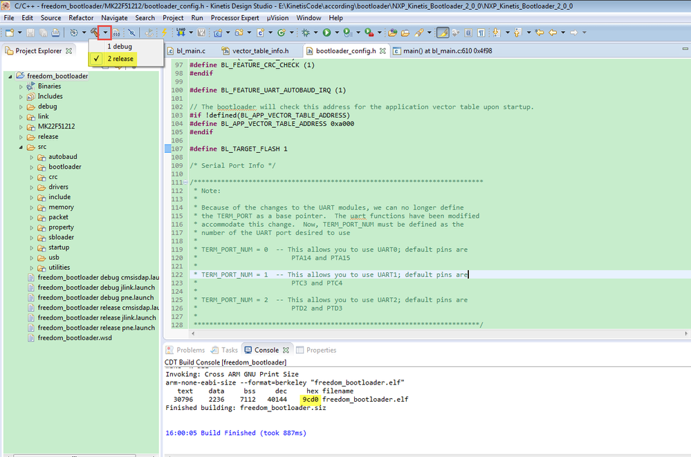

2. Build the release version
After build, check the console, hex size, it should below 0XA000.

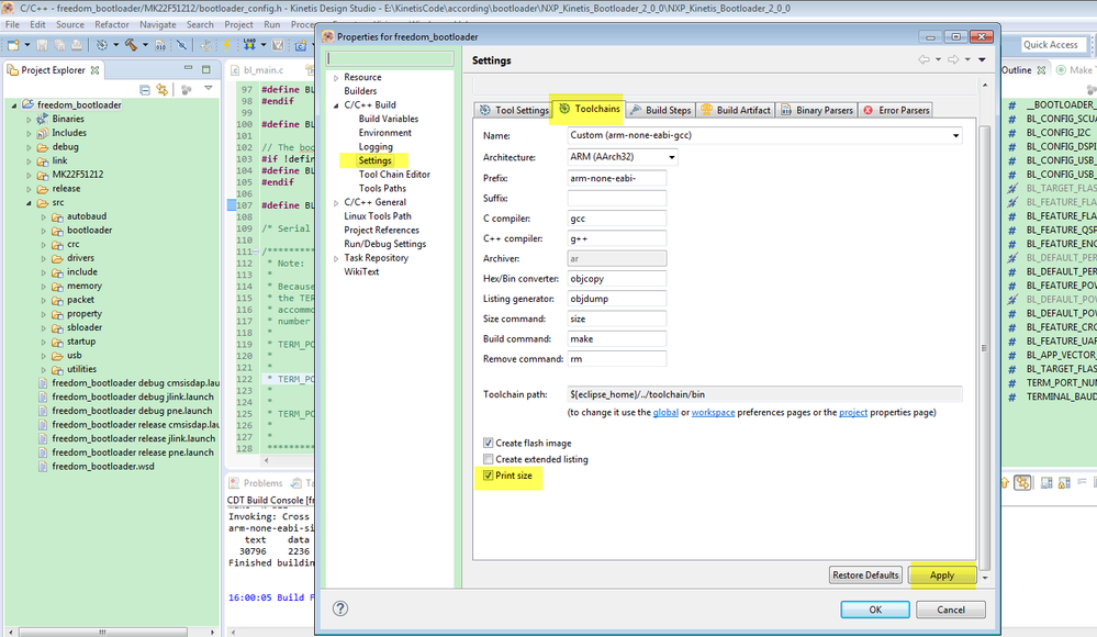

 print size can be enabled by the following way:

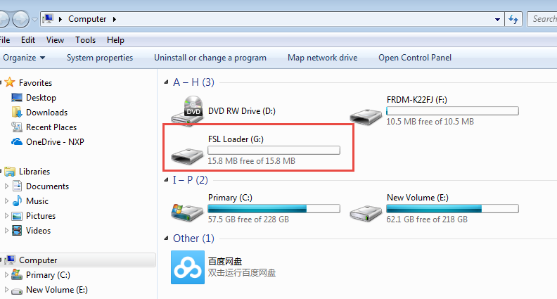

4. find another USB cable connect the USB port in the FRDM board, J16.
  You can find the FSL Loader device, this is the USB MSC interface
