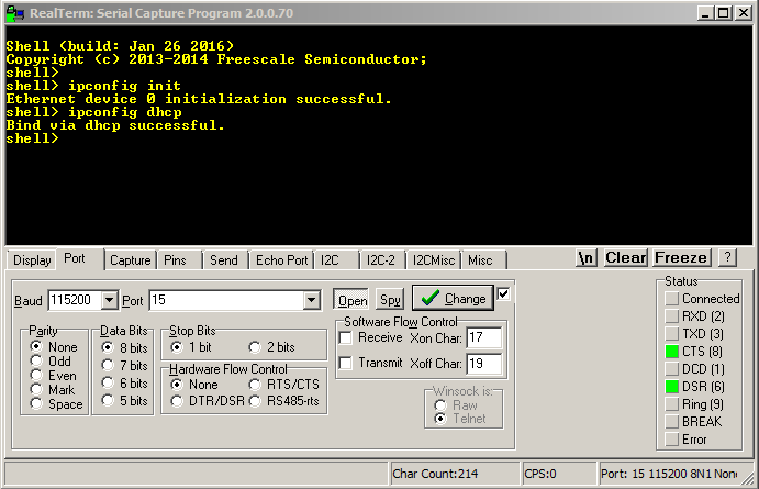

5- Using a Serial terminal (115200 bps,8N1) connected to the OpenSDA CDC interface (COM port), connect it to see the shell.Type ipconfig init and ipconfig dhcp to init the Ethernet interface and get a valid IP from the router.
6- Type help to see all the commands available.

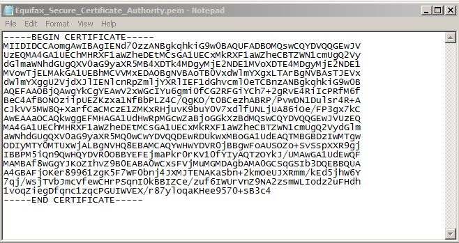

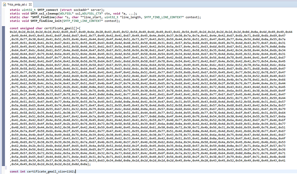

- The Certificate Authority (CA) file from Equifax, used for Gmail, is decoded in hexadecimal to a c array and it is located in the file rtcs_smtp_ssl.c , in the \middleware\tcpip\rtcs\source\apps folder:
- To connect to other servers with SSL support, you will need to obtain a valid Certificate Authority file for this server. You can do it in three steps: 1) Verify what is the certificate authority used by the server. One way to do it is using OpenSSL ( OpenSSL  ) ,  with s_client and the option -showcerts to see the server certificates and check the certificate Authority.Gmail uses Equifax as CA 2) After you know the Certificate Authority of the server, you can get the certificate file in pem file format on a e-mail client for PC (e.g. Outlook).In this case , Outlook has the Equifax certificate file.All the certificate files need to start with -----BEGIN CERTIFICATE----- and to finish with -----END CERTIFICATE----- ,as below 3) You need to convert your CA file to a c language array. You can use Bin2h to do the task.
     PEM file generated by Equifax before to be converted to a c array
All the files used to build the demo are included on the file attached. The SSL connection using the WolfSSL software is made on the file rtcs_smtp_ssl.c.
