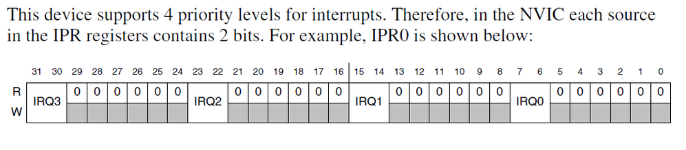

You may be using code from a Cortex-m4 based part rather than a Cortex-M0+ part.
Cortex-m4 (eg. K60 ) has 16 priority levels but the Cortex-M0+ (eg. KL05) has 4.
When you set it manually you are writing the value incorrectly to the register because it is left aligned and not right aligned.
This code will do it correctly:
unsigned char ucPriority  = 1; // (or whatever) 0..3 for KL05
NVIC_IPR5 = = (ucPriority << __NVIC_PRIORITY_SHIFT); // define the interrupt's priority (16 levels for K and 4 levels for KE/KL)
where
#define __NVIC_PRIORITY_SHIFT   6
is to be used for Cortex-M0+ based parts
and
#define __NVIC_PRIORITY_SHIFT   4
for Cortex-M4 parts.

NVIC_IPR5 = (ucPriority << (__NVIC_PRIORITY_SHIFT + 16))
since (INT_PIT - 16) % 4 = 2 we have have to set the priority for IRQ2 on NVIC_IPR5, or am I interpreting that wrong?  Otherwise you wouldn't be able to set the priority independently for each of the interrupts that share NVIC_IPR5.

KL05 PIT interrupt ID is 0x16 (22), so it needs to be set in the IRQ20_23_PRIORITY_REGISTER priority register (this is the 6th register in this area and therefore your framework presumably calls it NVIC_IPR5.
The actual bit involved to set a priority of 1 is 0x00400000, so your formula is correct.
You do still have an error though because
NVIC_IPR5 = (ucPriority << (__NVIC_PRIORITY_SHIFT + 16));
writes the other three neighbor vector priorities to 0 (if they were previously set), so the correct code when doing this particular interrupt's long word access would be:
NVIC_IPR5 = (NVIC_IPR5 & 0xff00ffff) | (ucPriority << (__NVIC_PRIORITY_SHIFT + 16)));
Therefore I prefer the simple byte access method (above) because it only requires the ID of the interrupt to be known and no calculating on the back of a napkin is needed each time one is used (with the associated risk of errors).

The NVIC is part of the Cortex core and so is not documented in the Kinetis user's manuals - you can get all core documentation from ARM: http://infocenter.arm.com/help/index.jsp?topic=/com.arm.doc.ddi0432c/Cihbecee.html
