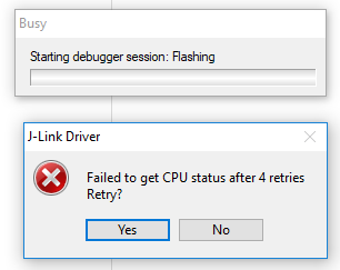

With IAR I am getting this error now. (As I am not able to connect)

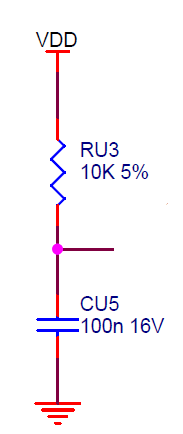

* RESET pin is pulled high in hardware using 10k resistor.
* I already tried a basic/simple program, to turn on the led, and I have the same problem now with all projects.

Reset Circuit is as below.
Please suggest.

Hello xpress-embedo
It seems that your kinetis is blocked, I suggest you refer to this post Communication error while accessing MDM-AP.  in order to unlock your micro.
Please let me know if the suggestion is helpful,
Omar
